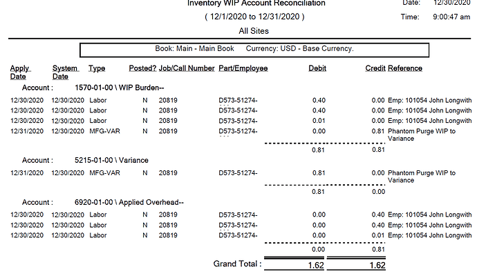

- WIP rounding
@jlongwith. Open the job and do job adjustment (material or labour or subcontract) for a cent which will uncheck WIPCleared flag. Then close it and run the Inventory WIP Reconciliation Report to see whether it’ creates varaince.
