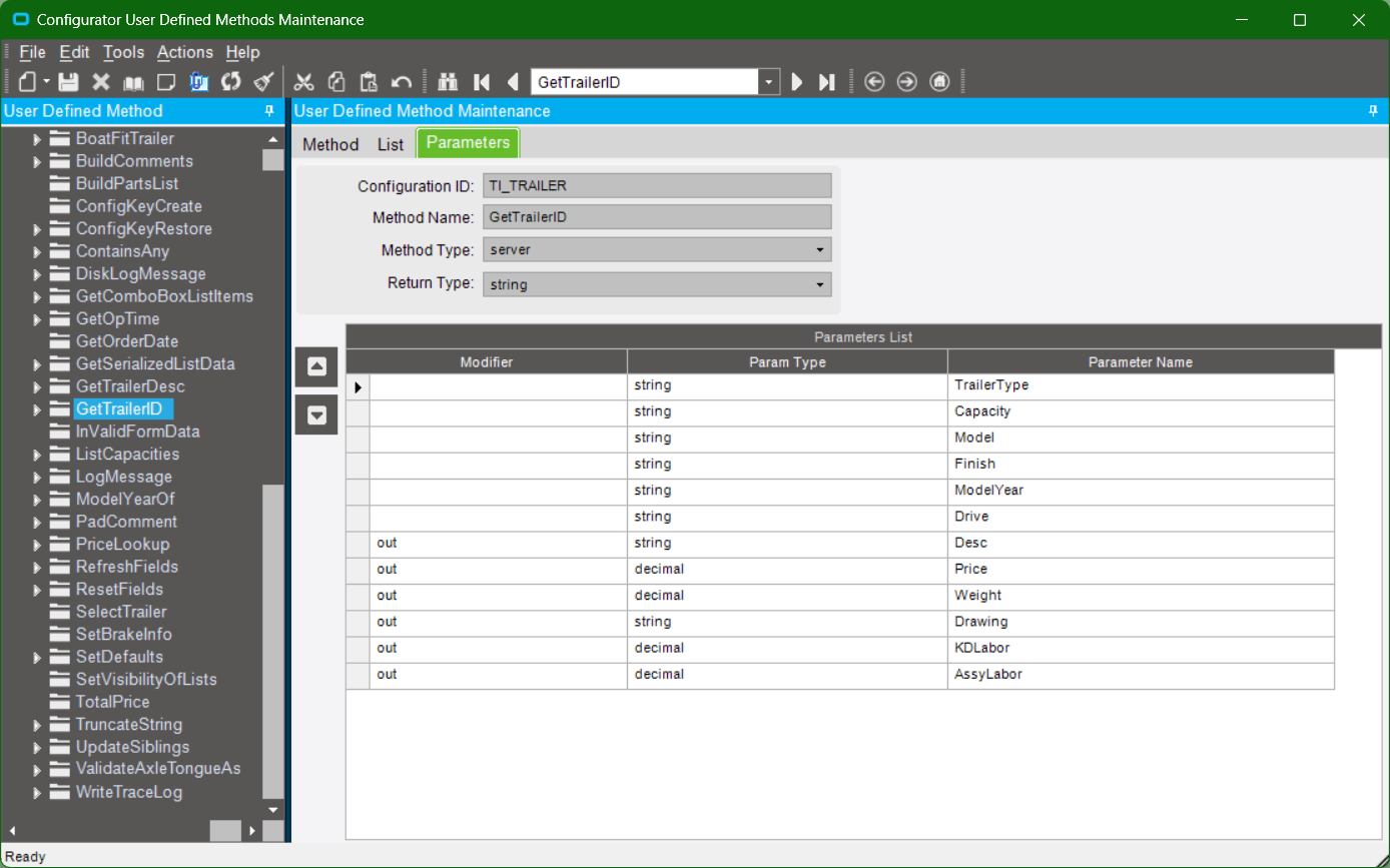

@timshuwy Mine works fine using params as inputs to the UD function:
var data = (from row in Db.PcConData where
    row.Company == Context.CompanyID
&&	row.PartNum == Context.ConfigurationID
&&	row.TypeCode == TrailerType
&&	row.Key1 == Model
&&	row.Key2 == Finish
&&	row.Key3 == Drive
&&	row.Key4 == Capacity
&&	row.Key5 == ModelYear
select row).FirstOrDefault();
This is not how I am suggesting you fix this, I’d need to see more code for that, but try this, and I bet you’ll get output.
