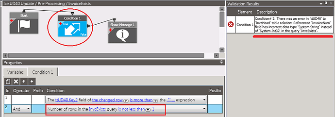

UD Table Relations - data type error - Number of Rows in xxx query

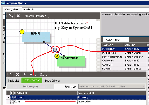

Wonder how/if I can verify that a “Key” value for a new record in a UD table
matches some other table.value?

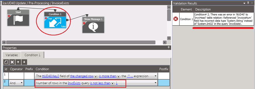

Tried using a query condition on a Method Directive for a UD Table update but…
That didn’t like my Table Relations - objected to linking a Key with a System.Int32 field.
Ref screen shots
I also tried some custom code, similar results, failing on Key == System.Int32

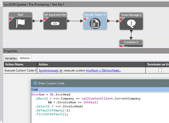

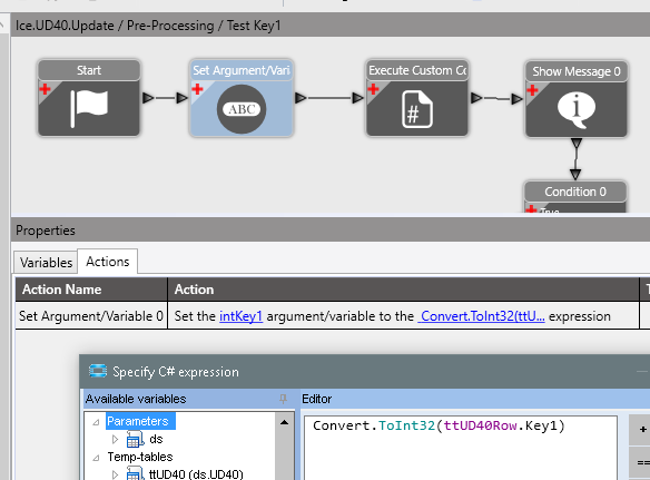

I’m just guessing at what you’re end goal is… But here’s a MD that prevents a UD40 record from being created if Key1 <> an existing InvcHead.InvoiceNum
It uses two variables
  • intKey1 is Key1 in Integer form
  • InvcNum is the InvoiceNum when an invoice number matching Key1 is found. If no invoice exists, InvcNum is set to -1
The first widget converts the Key1 to an integer and stores it in intKey1
The second widget finds an invoice with InvoiceNum = Key1. If no invoice found, it sets InvcNum to -1
The Show Message was just fro my debugging and testing.

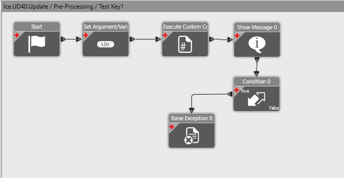

The condition widget:
Just tests the variable InvNum to make sure it is not -1.
Then I raise an exception to prevent the record from updating.

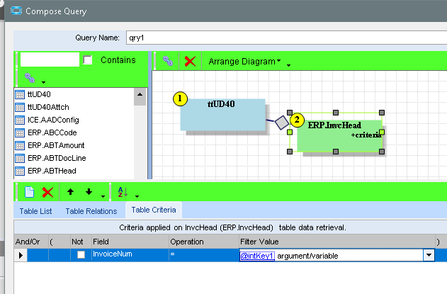

You might have only needed to add a variable and the Set Variable widget, to your original BPM.
I was able to do it with just the new variable and a “Number of rows in qry is not less than 1” condition:
The table Relations are just Company == Compnay`

In the table relations you can make the int col be: cast(MyIntColName as nvarchar)
Note that if the col name is ambiguous (exists in more than one table in query) make sure you prefix tablename: cast(MyTable.MyIntColName as nvarchar)
I think the query designer in the condition widget only allows yo to specify the column of each table (see the image in the original post). No expresions, and can’t even specify an operator. It is fixed at =. Also, the join type is fixed at INNER.
oh, thats tough
