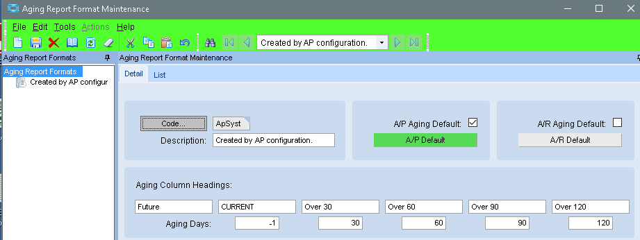

Did the report run properly before?
Any recent changes to the AP Aginging Report Format?
(talking about settings in this program, and not the actual format of the SSRS report)
