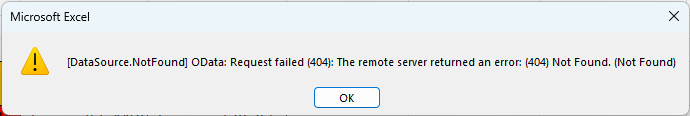

We pull a lot of BAQs into Excel via the v2 API, and odata. We use the API key, and an integration user account. These reports all ran fine last week, and far into the past. Today, I have several reports that won’t update in Excl via power query. I get this error:
I can run the BAQ in the editor without issues. I can also run the BAQ via the REST API helper. No issues there either. As soon as I try to run in Excel, I get that error. What did they break this time?
EDIT: from POwerQuery side this is what the error looks like:
DataSource.NotFound: OData: Request failed (404): The remote server returned an error: (404) Not Found. (Not Found)

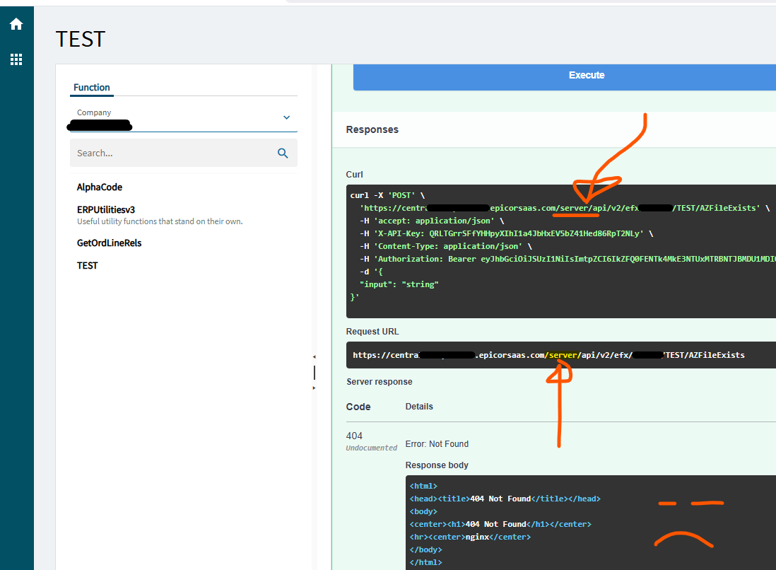

We’re running into a similar issue this morning in Power BI. My guess is that this is related to the Nginx maintenance they did this weekend. When I look at the BAQ in the Rest API Helper, I actually receive an error. The V1 version will give a 404 Nginx error specifically.
I just opened a ticket CS0005328282 in case you needed one for reference.

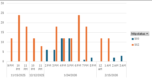

I’ve been writing 15 minutes logs from an integration I middleware’d several years ago, and I coincidentally happen to be reviewing the last few months today. Just for funsies as long as I’m here, here’s a low quality graph of the big HTTP error days from that period.
