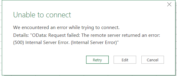

However, when i try to use MS Excel to connect using OData I get an error message.
The URL i am using is: https:////api/v2/odata/157554/BaqSvc/JEMPackSlips/Data
I have tried V1 also however that is not working either.
Any suggestions greatly appreciated.

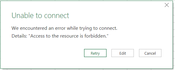

When I try V1 - again the SWAGGER page results show all the records. however, when try to connect with Excel i get:
