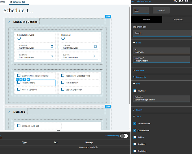

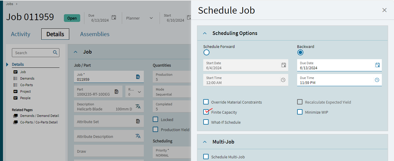

On the schedule job popup, we want the Finite Capacity box to default to checked. Many slide out screens in Kinetic have a “save defaults” option, but not this screen. SO, I went into Application Studio, hoping to find something to set default = true, but nothing. Any ideas??
I consider default options to be something in the realm of BPMs (e.i., set that field to true in a Post Method Directive of the GetNew/GetByID/GetXXX that is called)
An Application Studio option that is a bit risky (client-side is just more finicky) is to create an event that fires after that checkbox is created to set its value to true…

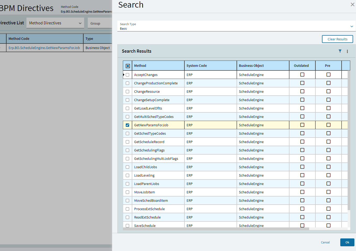

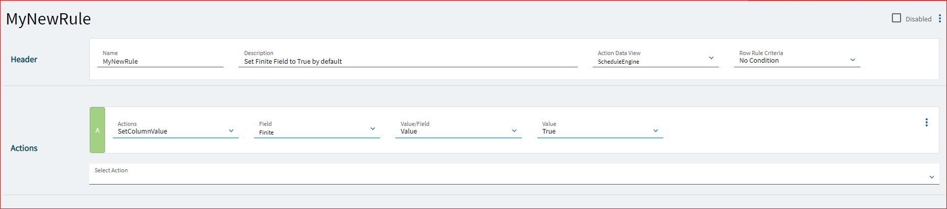

Okay, cool. I’ll look into that. For now I just tried a bunch of BPMs by having them throw an exception to find out which one was used on that popout screen. In the end, it was quite simple after I found it.
Thank you for your help!
