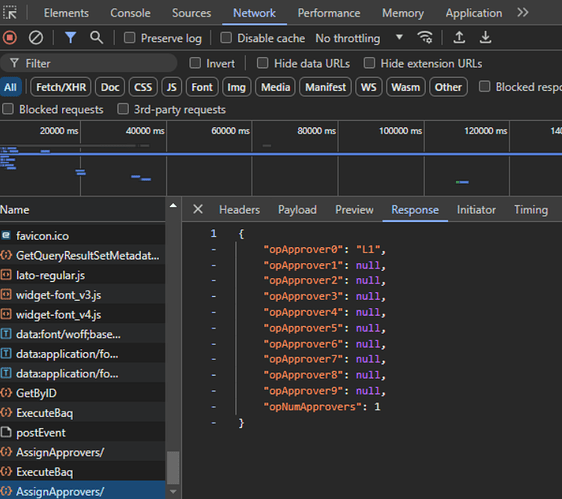

Are you debugging with the browser’s developer tools? Look in the network tab for calls to your function and check the response data. Look for the events happening in the console (use Ctrl+Alt+8 to turn on debug logging) and see what value it’s trying to set your NumOfApprovers_c field to

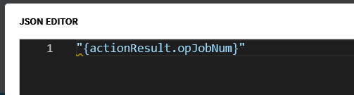

I’ve tried this with no success. It fails to save anything after clicking “save” in the JSON editor - unless it either is contained in quotes or is a constant number. I’ve also tried entering {actionResult.opNumApprovers} into the expression property - no success. I’ve double-checked the return variable’s name and it is correct. This is what I’m getting as a response (the opApprover null values are intended):
With @justint 's comments, I’m certain that it’s not a string vs int issue - and using the Value field appears to be totally correct. You’ve shown that your response data is named as expected.

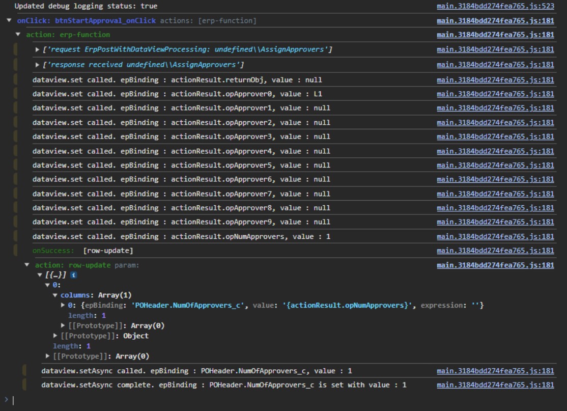

Could you show the actions of the event running? In the console, with debug logging turned on - the event actions will display as they happen.

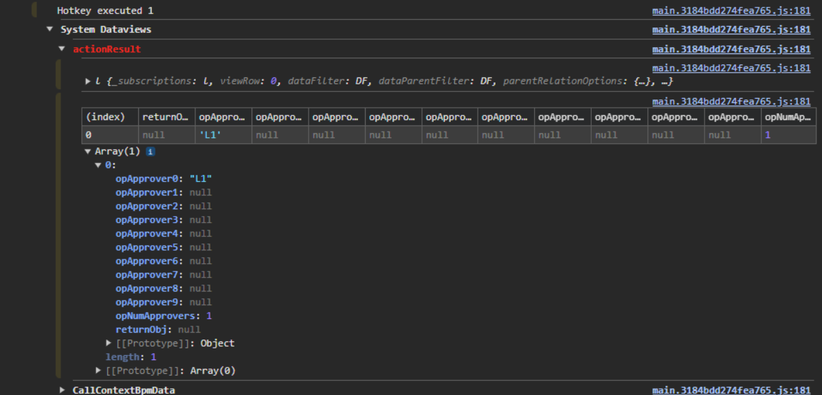

Also, check the dataview contents after: Ctrl+Alt+v will spit out all the current values of the dataviews - actionResult is under System Dataviews, and check the value of POHeader.NumOfApprovers_c
Hey Jonathan, this is what I’m able to find:

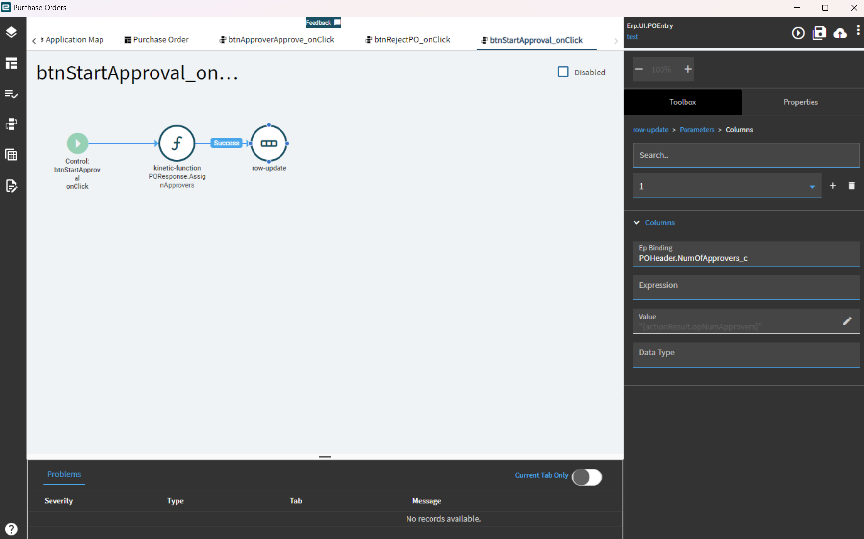

And here are the event’s actions:
Actually, it started working all of a sudden. Last time I tested it, I set the value back to “{actionResult.opNumApprovers}”, removed the expression, ran it, and it failed again. No changes have been made but now it successfully updates the field. Strange.
Welcome to the wonderful world of Epicor! After making a change, sometimes you have to close everything, and reopen it before it actually works - up to and including logging out and logging back in.
