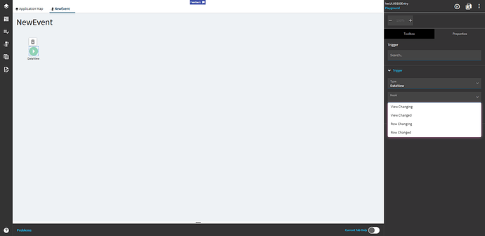

You can make your own event that can use the trigger of event before/after to do stuff.
If you truly want to call it to use the event, then in your custom event, use the event-next widget and enter the name of the event you wish to call.

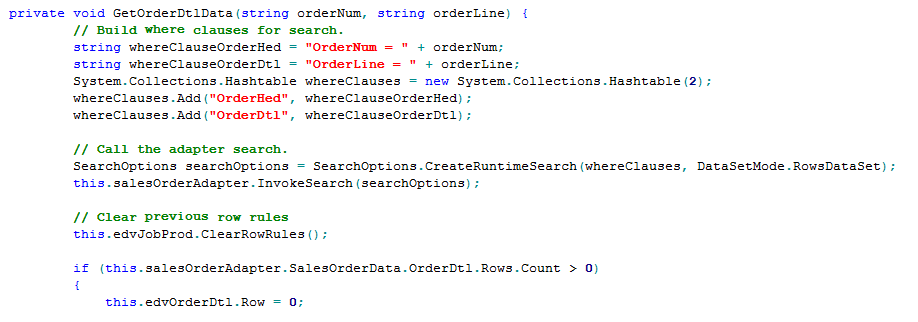

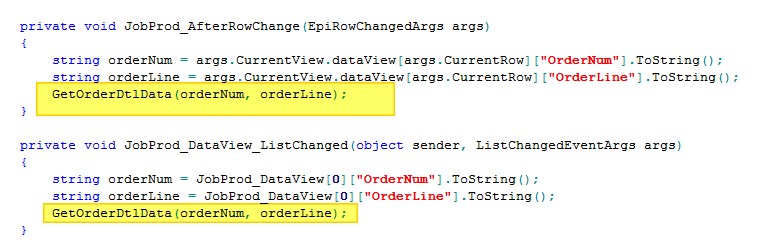

c# code has code in after_RowChange(I think here I need to user after row change event) but in the event it is taking value from current dataset and calling a sales order adapter.
Like this:How I can implement this in Application studio?
You should review the various triggers available to you.
and calling adapter with method? via Rest calling
Spot on.
