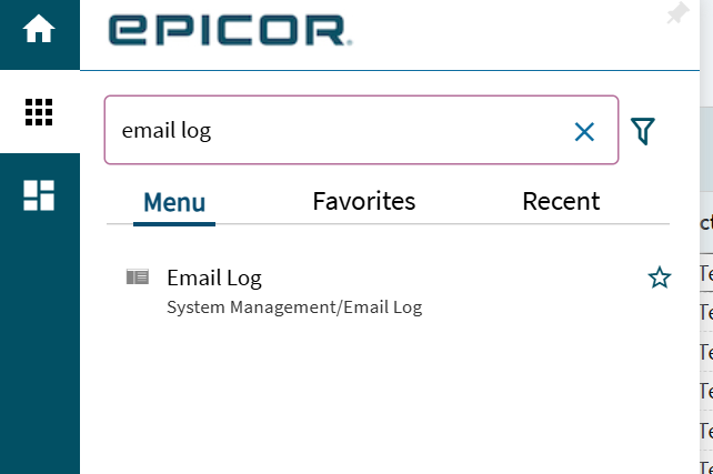

I would look at the email log and view the errors.

I checked the Email Log and I do not see anything listed (good or bad).

Is your email logging turned on? (Email Settings Maint.)?

Yes it is turned on
I did check there and do not see anything other than the password reset emails.
Mr. @dcamlin my email logging is turned on as well.
I should mention that do see an entry from this morning where i had to reset a password - i can see that log entry.
