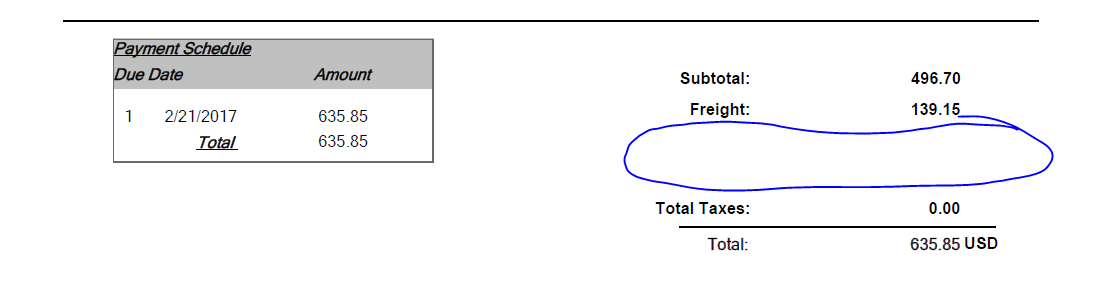

Regardless of this, maybe you can help me with another issue if you are familiar with editing reports in Report Builder.
This is what a section of the report looks like in Report Builder.
And this is what is printed.
The values are correct but there is a big white space between Freight and Total Taxes, but it doesn’t appear this way in the editor. What could cause this jump in formatting?
One thing you could check is the padding setting on each text box (specifically the Freight bottom padding and Total Taxes top padding). In text box properties, that’s under the Alignment tab.
There could be something going on with the Payment Schedule box. Maybe try hiding that to see if it changes anything.
If none of that work, you might be able to put those values in a table instead of individual boxes, which should keep it all together.
That fixed that! There was a little bit of padding on a few of the textboxes. After making them all 0pt, the blank space went away. Thanks for that easy fix! Now to fix the other problem…
Edit: Actually it was the Payment Schedule box like you mentioned. The real fix was putting these elements in their own Rectangle!
