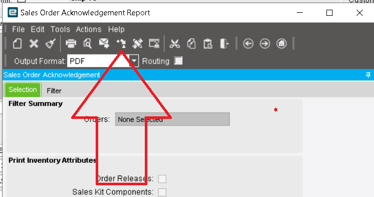

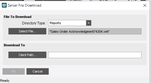

One trick i was shown for Cloud Customers - change the report style output to XML.
Run the report (generate only) and then use the “Server File Download” to download the xml and scan the schema to make sure you have the field name spelled correctly, and the field data is present.

I was able to get the xml file to view. I don’t see that column field listed anywhere

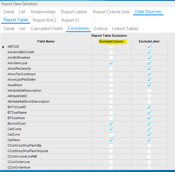

I see the boxes are checked above. You need to clear the box to include the field - unless something has changed since 2021.2.
I’m not sure we can do it.
ShipToContactName is a calculated field. (Which works) (In the report already)
Just unexcluding it doesn’t work.
