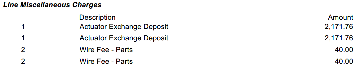

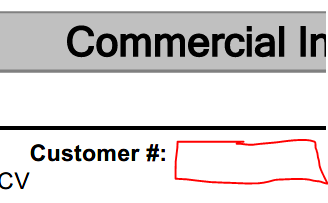

If I DELETE that last left out join of the Customer table, the duplicate miscellaneous line charges go away, but then I am not able to show the Cust ID. Is my join setup incorrect?

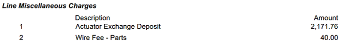

Duplicated:

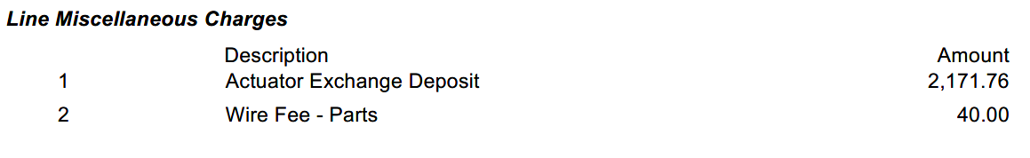

Not Duplicated:
But then without Cust ID:

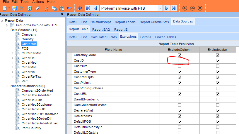

Just copy it and untick “Exclude Column”

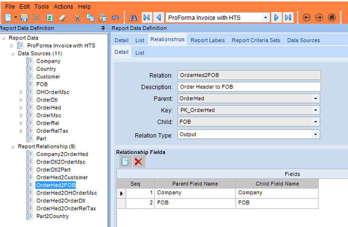

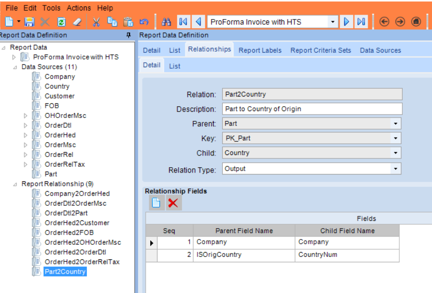

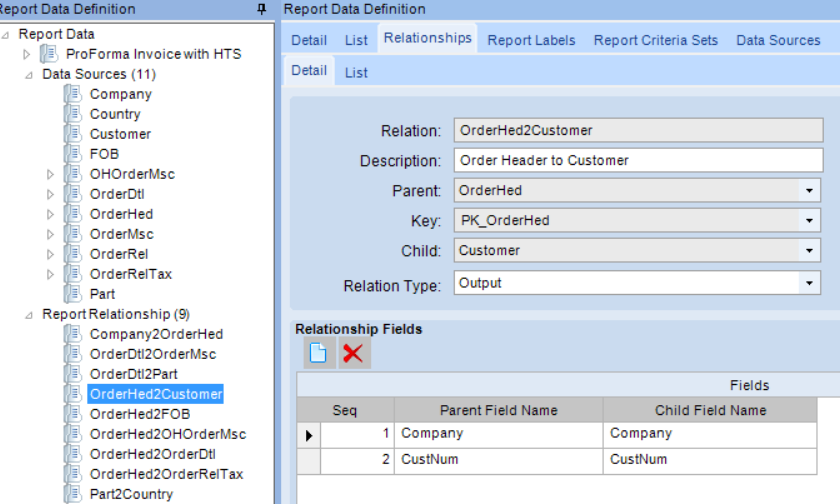

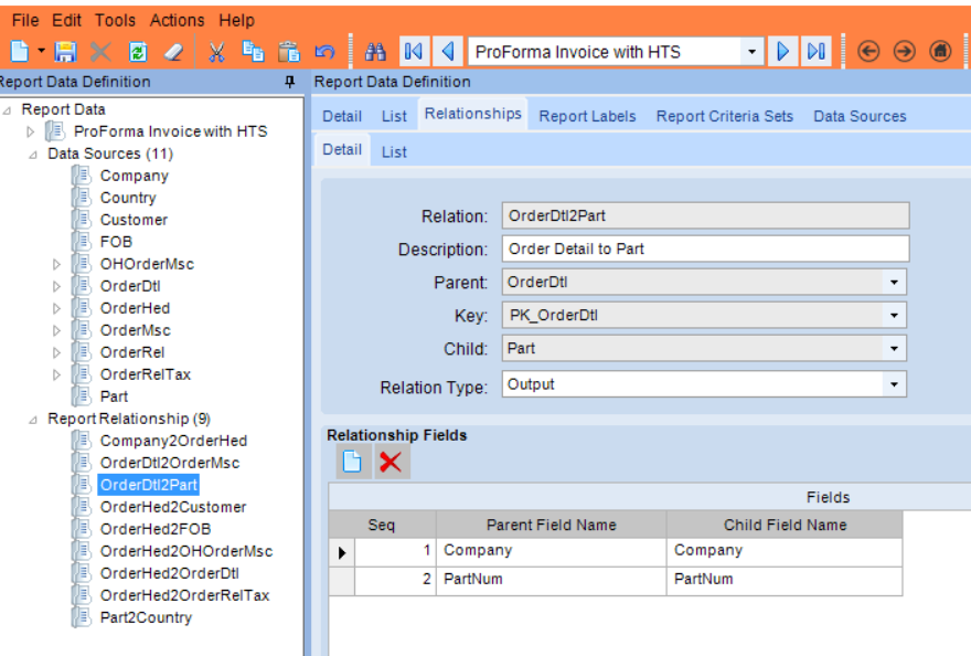

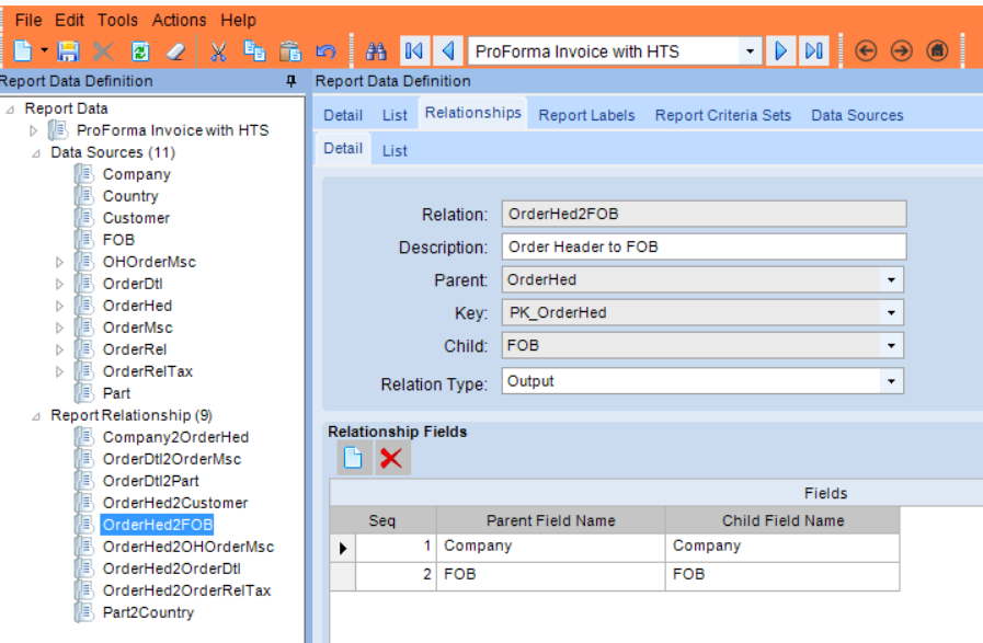

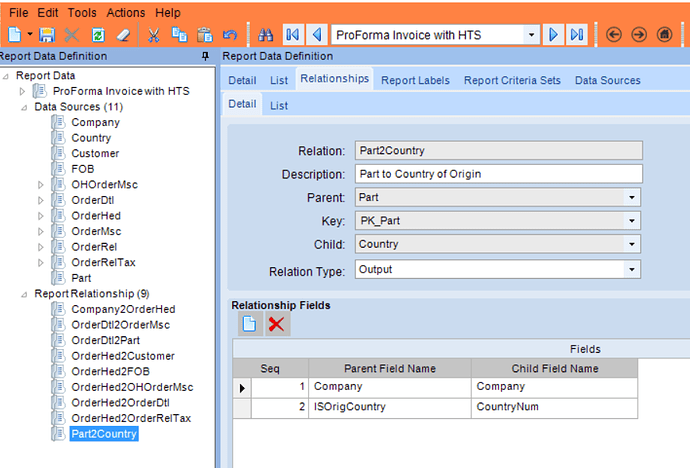

Compared to the standard RDD, I added 4 additional relationships (OrderDtl2Part, OrderHed2Customer, OrderHed2FOB, and Part2Country).

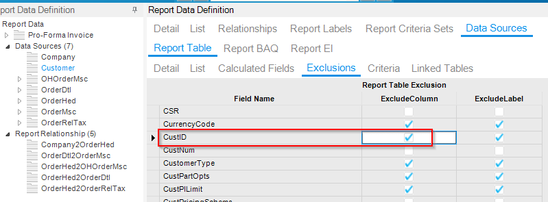

@Wunschi , I do have CustID un-excluded:
But I don’t have the Customer table linked to the OrderHed (through LinkedTables). I thought that is what my additional relationship (OrderHed2Customer) would do.

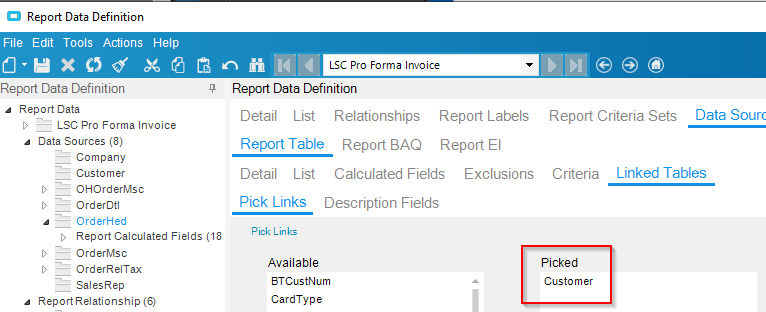

Either way, the CustID field should be available through Linked Tables… If you add “Customer” as a Picked Link, then go to the Description Fields tab it should give you a CustID.
Even though there is not a join called out in the RDD, Epicor has built the join in the background. Just add the table and join to the report query and add the field and you should be fine. Took me a long time to figure that one out. The best way to check these types of things is to run the report with retention of a day and then do a SQL query against the report DB for the tables included in the RDD.

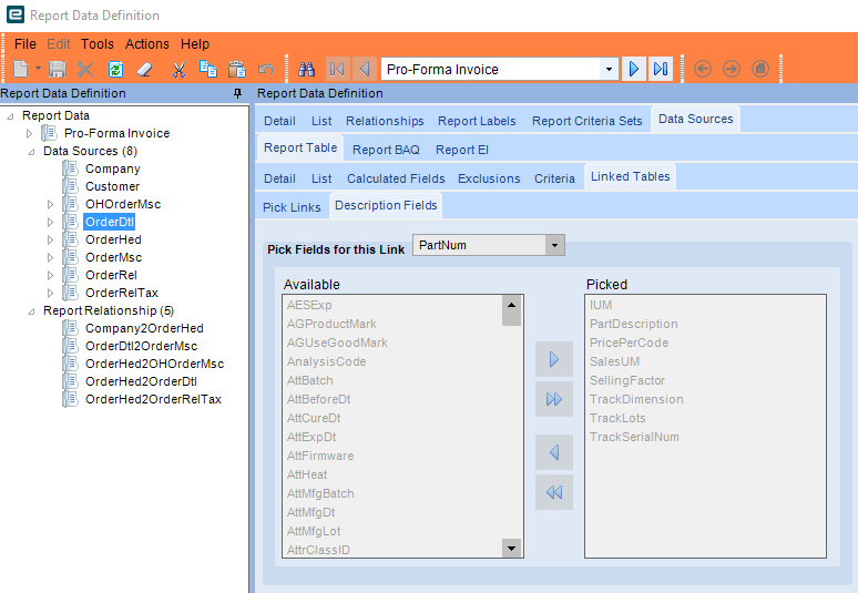

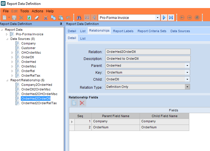

This is confusing, because a relationship between Order Header and Customer is pretty obvious, but so is the relationship between Order Header to Order Detail and a Report Relationship is shown on the standard RDD for Pro-Forma Invoice for OrderHed2OrderDtl, but NOT for OrderHed2Customer:
The only linked table on the standard RDD for Pro-Forma Invoice is for OrderDtl to PartNum:
If I delete my created RDD Report Relationship of OrderHed2Customer, and do nothing else to my RDL file, then my duplicate Line Miscellaneous Charges go away.
It is really confusing as it does not make much sense and I don’t even know why it works the way it does.

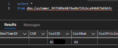

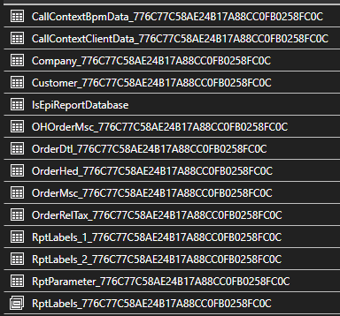

I just ran the Pro-Forma standard report and below is the list of tables that were created for the report, notice that Customer is there.
Out of the box, the CustID field is not included, so I need to create a new RDD. Once I have created the new RDD, I change the default report to use the new RDD. When I run that and then go look in the Customer table that was created, you can see the CustID is there.
Now you just need to get it into the report. Change the Dataset query of the report to include the Customer table, like this.

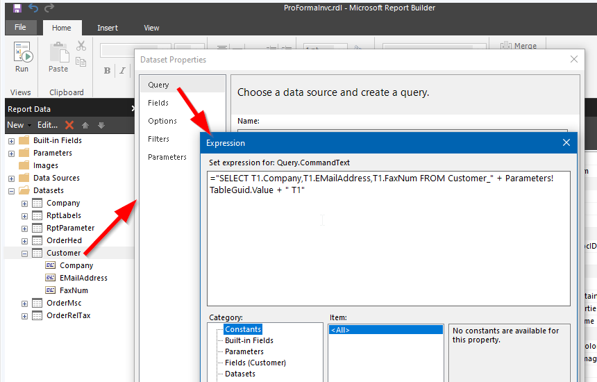

Hmmm … The Customer_GUID table is its own Dataset in the ProFormaInvc.RDL
You should be able to add the CustID field to the SELECT clause here, and add the Query Fields.
No additional joins should be necessary.

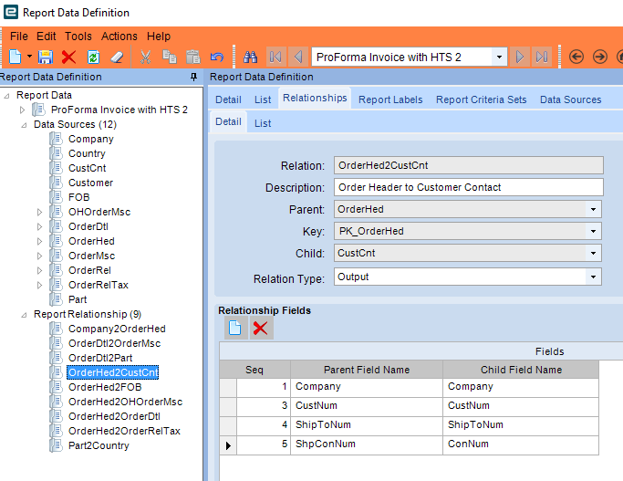

I have tried adding the CustCnt table with the following relationship to the OrderHed:
I get no error when I upload the rdl files, but when I try to generate a report, it fails to generate and the System Monitor give me a ServerError.

So I rewrote my RDL Left Outer Join statement for the CustCnt table and instead of using all 4 relationship links that I used on my RDD, I only used 2:
LEFT OUTER JOIN CustCnt_" + Parameters!TableGuid.Value + " T8
ON T1.Company = T8.Company AND T1.CustNum = T8.CustNum
Then I named the datafield CustCnt_Name so I could add it in the correct location on Report Builder.
Every test I tried brought in the Ship To Contact name, so it looks like it is working.
