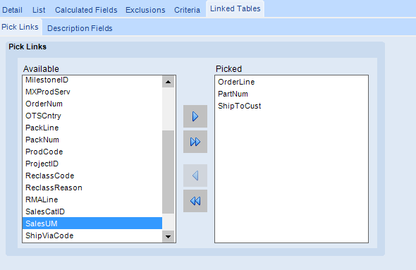

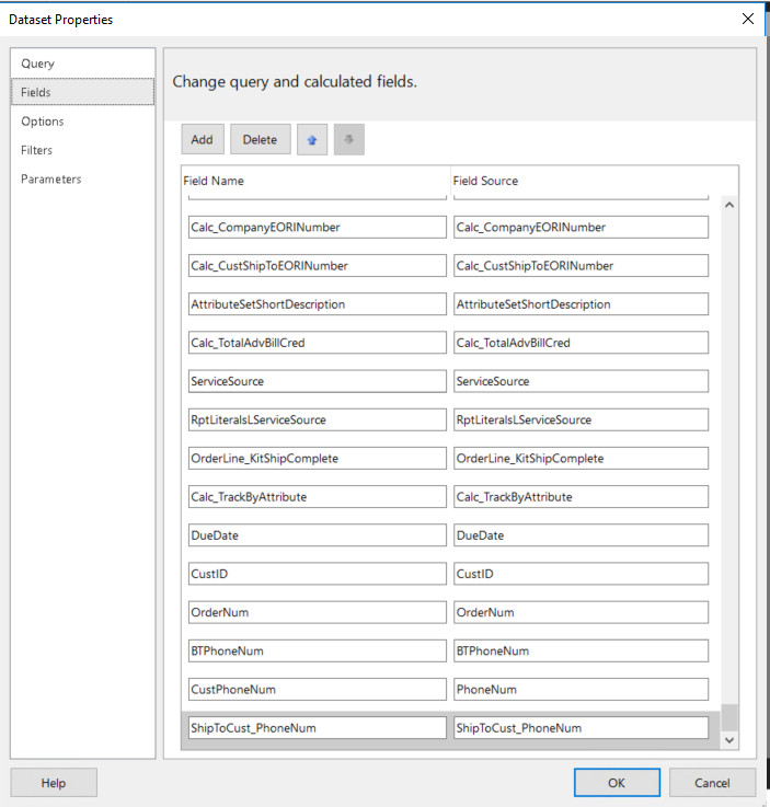

added ShipToCust as a Pick Link to InvcDtl:
added PhoneNum as a Description Field:

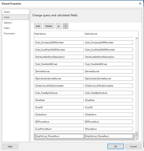

added ShipToCust_PhoneNum field to the Dataset:

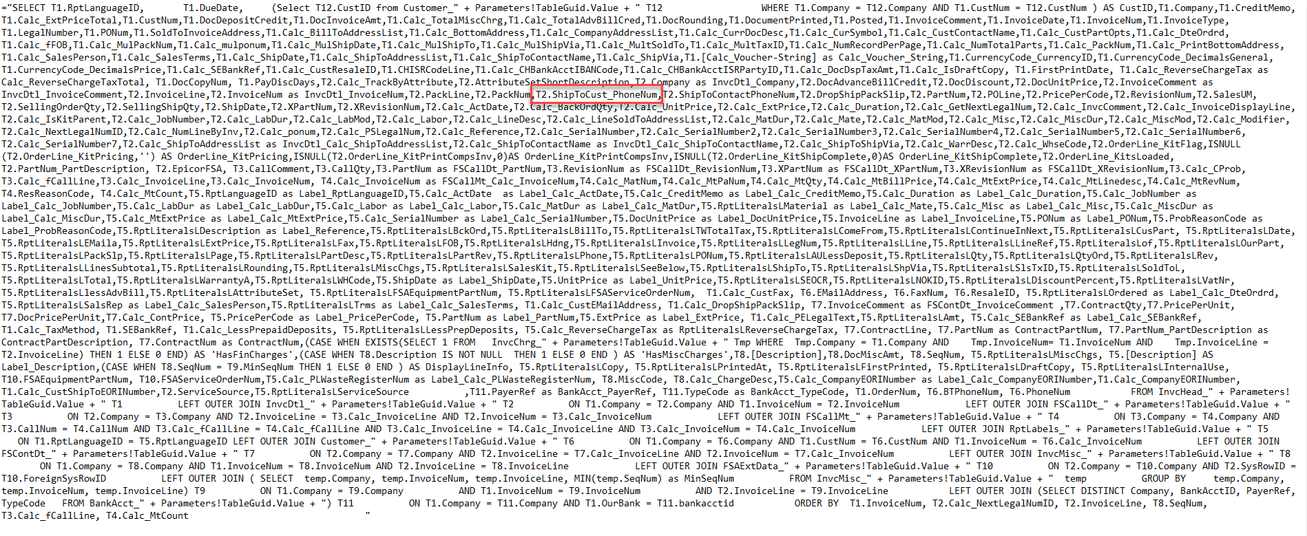

added T2.ShipToCust_PhoneNum to the Query:

Then I added the query field:
(Field Name - > Field Source)
ShipToCustPhonePhoneNum

SELECT T1.RptLanguageID,T1.Company,T1.CreditMemo,T1.Calc_ExtPriceTotal,T1.CustNum,T1.DocDepositCredit,T1.DocInvoiceAmt,T1.Calc_TotalMiscChrg,T1.DocRounding,T1.DocumentPrinted,T1.Posted,T1.InvoiceComment,T1.InvoiceDate,T1.InvoiceNum,T1.InvoiceType,T1.LegalNumber,T1.PONum,T1.SoldToInvoiceAddress,T1.Calc_BillToAddressList,T1.Calc_BottomAddress,T1.Calc_CompanyAddressList,T1.Calc_CurrDocDesc,T1.Calc_CurSymbol,T1.Calc_CustContactName,T1.Calc_CustPartOpts,T1.Calc_DteOrdrd,T1.Calc_fFOB,T1.Calc_MulPackNum,T1.Calc_mulponum,T1.Calc_MulShipDate,T1.Calc_MulShipTo,T1.Calc_MulShipVia,T1.Calc_MultSoldTo,T1.Calc_MultTaxID,T1.Calc_NumRecordPerPage,T1.Calc_NumTotalParts,T1.Calc_PackNum,T1.Calc_PrintBottomAddress,T1.Calc_SalesPerson,T1.Calc_SalesTerms,T1.Calc_ShipDate,T1.Calc_ShipToAddressList,T1.Calc_ShipToContactName,T1.Calc_ShipVia,T1.[Calc_Voucher-String] as Calc_Voucher_String,T1.CurrencyCode_CurrencyID,T1.CurrencyCode_DecimalsGeneral,T1.CurrencyCode_DecimalsPrice,T1.Calc_SEBankRef,T1.Calc_CustResaleID,T1.BranchID,T1.CustAgentTaxRegNo,T1.CHISRCodeLine,T1.Calc_CHBankAcctIBANCode,T1.Calc_CHBankAcctISRPartyID, T1.InvoiceRef, T1.CMReason,T1.Calc_DocDspTaxAmt, T1.RevisionNum AS InvcHead_RevisionNum, T1.RevisionDate AS InvcHead_RevisionDate, T1.Calc_IsDraftCopy, T1.FirstPrintDate, T1.Calc_ReverseChargeTax as Calc_ReverseChargeTaxTotal, T1.DocCopyNum, T1.PayDiscDays, T2.AdvanceBillCredit,T2.Company as InvcDtl_Company,T2.DocAdvanceBillCredit,T2.DocDiscount,T2.DocUnitPrice,T2.InvoiceComment as InvcDtl_InvoiceComment,T2.InvoiceLine,T2.InvoiceNum as InvcDtl_InvoiceNum,T2.PackLine,T2.PackNum,T2.DropShipPackSlip,T2.PartNum,T2.POLine,T2.PricePerCode,T2.RevisionNum,T2.SalesUM,T2.SellingOrderQty,T2.SellingShipQty,T2.ShipDate,T2.XPartNum,T2.XRevisionNum,T2.Calc_ActDate,T2.Calc_BackOrdQty,T2.Calc_UnitPrice,T2.Calc_ExtPrice,T2.Calc_Duration,T2.Calc_GetNextLegalNum,T2.Calc_InvcComment,T2.Calc_InvoiceDisplayLine,T2.Calc_IsKitParent,T2.Calc_DspDocLineTax,T2.Calc_JobNumber,T2.Calc_LabDur,T2.Calc_LabMod,T2.Calc_Labor,T2.Calc_LineDesc,T2.Calc_LineSoldToAddressList,T2.Calc_MatDur,T2.Calc_Mate,T2.Calc_MatMod,T2.Calc_Misc,T2.Calc_MiscDur,T2.Calc_MiscMod,T2.Calc_Modifier,T2.Calc_NextLegalNumID,T2.Calc_NumLineByInv,T2.Calc_ponum,T2.Calc_PSLegalNum,T2.Calc_Reference,T2.Calc_SerialNumber,T2.Calc_SerialNumber2,T2.Calc_SerialNumber3,T2.Calc_SerialNumber4,T2.Calc_SerialNumber5,T2.Calc_SerialNumber6,T2.Calc_SerialNumber7,T2.Calc_ShipToAddressList as InvcDtl_Calc_ShipToAddressList, T2.Calc_ShipToContactName as InvcDtl_Calc_ShipToContactName,T2.Calc_ShipToShipVia,T2.Calc_StateTaxID,T2.Calc_WarrDesc,T2.Calc_WhseCode,T2.OrderLine_DisplaySeq,T2.OrderLine_KitFlag,ISNULL(T2.OrderLine_KitPricing,'') AS OrderLine_KitPricing,ISNULL(T2.OrderLine_KitPrintCompsInv,0)AS OrderLine_KitPrintCompsInv,T2.OrderLine_KitsLoaded,T2.OrderLine_OrderLine,T2.PartNum_PartDescription, T2.EpicorFSA, T3.CallComment,T3.CallQty,T3.PartNum as FSCallDt_PartNum,T3.RevisionNum as FSCallDt_RevisionNum,T3.XPartNum as FSCallDt_XPartNum,T3.XRevisionNum as FSCallDt_XRevisionNum,T3.Calc_CProb,T3.Calc_fCallLine,T3.Calc_fCallNum,T3.Calc_InvoiceLine,T3.Calc_InvoiceNum, T4.Calc_InvoiceNum as FSCallMt_Calc_InvoiceNum,T4.Calc_MatNum,T4.Calc_MtPaNum,T4.Calc_MtQty,T4.Calc_MtBillPrice,T4.Calc_MtExtPrice,T4.Calc_MtLinedesc,T4.Calc_MtRevNum,T4.ResReasonCode, T4.Calc_MtCount,T5.RptLanguageID as Label_RptLanguageID,T5.Calc_ActDate  as Label_Calc_ActDate,T5.Calc_CreditMemo as Label_Calc_CreditMemo,T5.Calc_Duration as Label_Calc_Duration,T5.Calc_JobNumber as Label_Calc_JobNumber,T5.Calc_LabDur as Label_Calc_LabDur,T5.Calc_Labor as Label_Calc_Labor,T5.Calc_MatDur as Label_Calc_MatDur,T5.RptLiteralsLMaterial as Label_Calc_Mate,T5.Calc_Misc as Label_Calc_Misc,T5.Calc_MiscDur as Label_Calc_MiscDur,T5.Calc_MtExtPrice as Label_Calc_MtExtPrice,T5.Calc_SerialNumber as Label_Calc_SerialNumber,T5.DepositCredit as Label_DepositCredit,T5.DocUnitPrice as Label_DocUnitPrice,T5.InvoiceLine as Label_InvoiceLine,T5.PONum as Label_PONum,T5.ProbReasonCode as Label_ProbReasonCode
,T5.RptLiteralsLBckOrd,T5.RptLiteralsLBillTo ,T5.RptLiteralsLTWTotalTax ,T5.RptLiteralsLComeFrom ,T5.RptLiteralsLContinueInNext ,T5.RptLiteralsLCusPart , T5.RptLiteralsLDate ,T5.RptLiteralsLEMaila ,T5.RptLiteralsLExtPrice
,T5.RptLiteralsLFax ,T5.RptLiteralsLFOB ,T5.RptLiteralsLHdng ,T5.RptLiteralsLInvoice ,T5.RptLiteralsLLegNum ,T5.RptLiteralsLLine ,T5.RptLiteralsLLineRef ,T5.RptLiteralsLof ,T5.RptLiteralsLOurPart ,T5.RptLiteralsLPackSlp ,T5.RptLiteralsLPage ,T5.RptLiteralsLPartDesc ,T5.RptLiteralsLPartRev  ,T5.RptLiteralsLPhone ,T5.RptLiteralsLPONum ,T5.RptLiteralsLAULessDeposit ,T5.RptLiteralsLQty ,T5.RptLiteralsLQtyOrd ,T5.RptLiteralsLRev ,T5.RptLiteralsLLinesSubtotal ,T5.RptLiteralsLRounding ,T5.RptLiteralsLMiscChgs, T5.RptLiteralsLSalesKit ,T5.RptLiteralsLSeeBelow ,T5.RptLiteralsLShipTo ,T5.RptLiteralsLShpVia ,T5.RptLiteralsLSlsTxID ,T5.RptLiteralsLSoldToL ,T5.RptLiteralsLTotal ,T5.RptLiteralsLWarrantyA ,T5.RptLiteralsLWHCode ,T5.ShipDate as Label_ShipDate,T5.UnitPrice as Label_UnitPrice,T5.RptLiteralsLSEOCR ,T5.RptLiteralsLNOKID ,T5.RptLiteralsLDiscountPercent ,T5.RptLiteralsLVatNr ,T5.RptLiteralsLlessAdvBill, T5.RptLiteralsLFSAEquipmentPartNum, T5.RptLiteralsLFSAServiceOrderNum,  T1.Calc_CustFax, T6.EMailAddress, T6.FaxNum, T6.ResaleID, T5.RptLiteralsLOrdered as Label_Calc_DteOrdrd,T5.RptLiteralsLSalsRep as Label_Calc_SalesPerson,T5.RptLiteralsLTrms as Label_Calc_SalesTerms, T1.Calc_CustEMailAddress, T1.Calc_DropShipPackSlip, T7.InvoiceComment as FSContDt_InvoiceComment ,T7.ContractQty,T7.PricePerUnit,T7.DocPricePerUnit,T7.Calc_ContPrice, T5.PricePerCode as Label_PricePerCode, T5.PartNum as Label_PartNum,T5.ExtPrice as Label_ExtPrice, T1.Calc_PELegalText, T1.Calc_DocInvoiceAmt, T5.RptLiteralsLAmt, T5.Calc_SEBankRef as Label_Calc_SEBankRef, T1.Calc_TaxMethod, T1.SEBankRef, T1.Calc_LessPrepaidDeposits, T5.RptLiteralsLLessPrepDeposits, T5.Calc_ReverseChargeTax as RptLiteralsLReverseChargeTax, T7.ContractLine, T7.PartNum as ContractPartNum, T7.PartNum_PartDescription as ContractPartDescription, T7.ContractNum as ContractNum ,(CASE WHEN EXISTS(SELECT 1 FROM   InvcChrg_" + Parameters!TableGuid.Value + " Tmp WHERE  Tmp.Company = T1.Company AND    Tmp.InvoiceNum= T1.InvoiceNum AND    Tmp.InvoiceLine = T2.InvoiceLine) THEN 1 ELSE 0 END) AS 'HasFinCharges', (CASE WHEN T8.Description IS NOT NULL  THEN 1 ELSE 0 END ) AS 'HasMiscCharges', T8.[Description], T8.DocMiscAmt, T8.SeqNum, T5.RptLiteralsLMiscChgs, T5.[Description] AS Label_Description,(CASE WHEN T8.SeqNum = T9.MinSeqNum THEN 1 ELSE 0 END ) AS DisplayLineInfo, T5.RptLiteralsLCopy, T5.RptLiteralsLPrintedAt, T5.RptLiteralsLFirstPrinted, T5.RptLiteralsLDraftCopy, T5.RptLiteralsLInternalUse, T10.FSAEquipmentPartNum, T10.FSAServiceOrderNum,T5.Calc_PLWasteRegisterNum as Label_Calc_PLWasteRegisterNum, T8.MiscCode, T8.Calc_ChargeDesc,T5.Calc_CompanyEORINumber as Label_Calc_CompanyEORINumber,T1.Calc_CompanyEORINumber,T1.Calc_CustShipToEORINumber
          ,T11.PayerRef as BankAcct_PayerRef, T11.TypeCode as BankAcct_TypeCode, T2.OrderNum
, T2.OrderLine, T1.SalesRepList, T12.PhoneNum           FROM InvcHead_" + Parameters!TableGuid.Value + " T1

For testing, I brought it in via linked table to ShipToCust, and get the sold to phone number.
(I believe that is a bug, and we should report it.)
When I bring it in via adding the table and linking with relationships like I showed above, I get the correct ship to phone number.

I got it to work. The issue was that both the field source for Sold To Phone Number and Ship To Phone Number was “PhoneNum” and the query was also calling it the same way. I just had to reference each one individually in the query and update the field source names

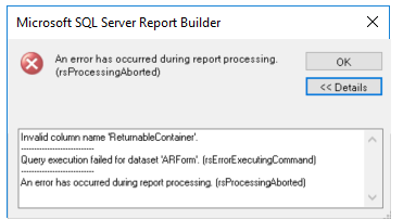

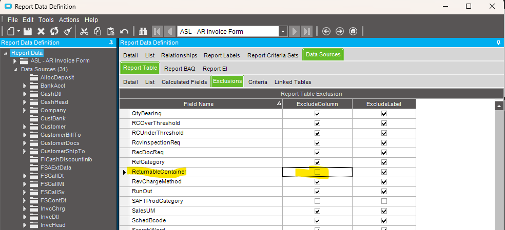

Hello All - I have been reading this one and can’t seem to find a re-solve to my issue…
What I need to do is add a Field to an AR Invoice….
This is what I have done….
  1. Started with Copied the RDD Files and calling it “ASLARFORMV3” in Pilot.
  2. Then I unticked the Field Name “ReturnableContainer” as this is the field I need to add to the AR Invoice. (Attached)
  3. Then I changed the “Data Definition” in the Report Style to the new RDD. (Attached)
  4. Then I logged onto the Server and opened the SSRS Report in Report Builder.

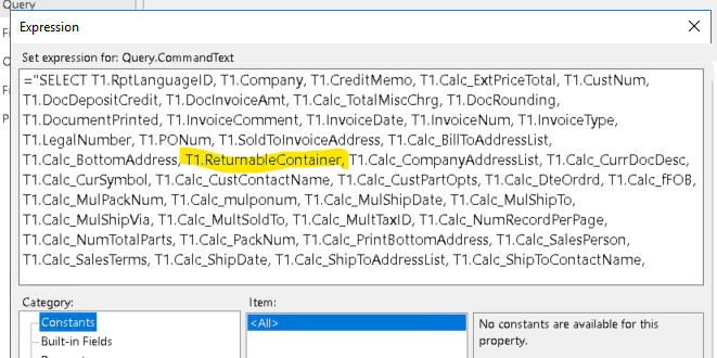

  5. With the ReturnableContainer as T1. ReturnableContainer,

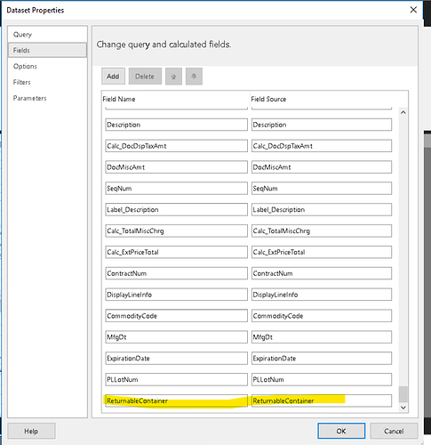

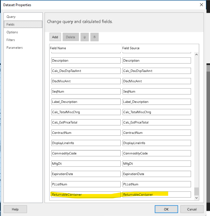

  6. Then I added the Field to the “Data Set Properties” (Attached)
Screenshot Expression
Screenshot SSRS Error
