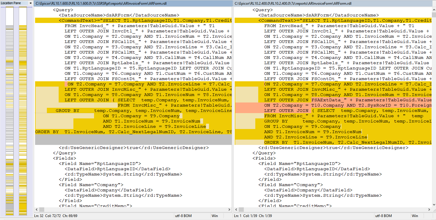

Here is my Customized ARForm Report 10.1.600 v 10.2.400. Before and After Upgrade.
However Epicor will not modify your .rdl file and add anything new into that! But if let’s say your rdl uses Calculated_Something and Epicor changed the logic, renamed it or removed it - you have to uplift it manually. (CC @JeffLeBert)
What I do usually is grab the base and compare it using www.winmerge.org and then make a decision, sometimes its easier to re-customize from Base.
But definitely look at your RDD first.
As you can see the ARForm has a gazillion changes.

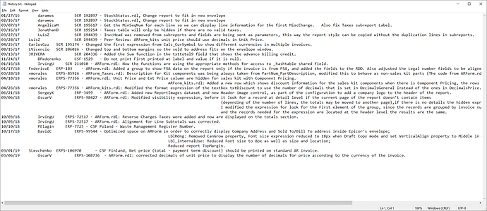

Also on your Server where Epicor Extracts the .iso etc you will find a reports.zip folder sometimes your lucky reports have a History.txt

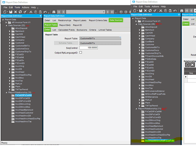

I’ve taken the new 10.2 RDD and added my other tables and relationships that my HIGHLY customized Invoice uses.
I’ve run the stock SSRS report using this new RDD and the base report prints so that tells me the RDD is NOT the culprit.

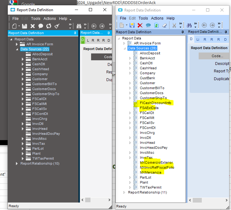

The issue I had was that there was some new data sources in the 10.2.4 RDD
I did a quick check of the ARForm RDD on 10.1.6 and 10.2.4 and there are new sources.
I suggest adding these to your custom RDD - it worked for me.

Regardless, you’re right about the added data sources. I’ve actually taken the base 10.2 RDD and added my 3 tables and their relationships and the form is now working. The only issue is I have one field left to add in the dataset query and it’s a SUM so I’m going to have to add a GROUP BY on all the other fields in the query, which is going to take some time.

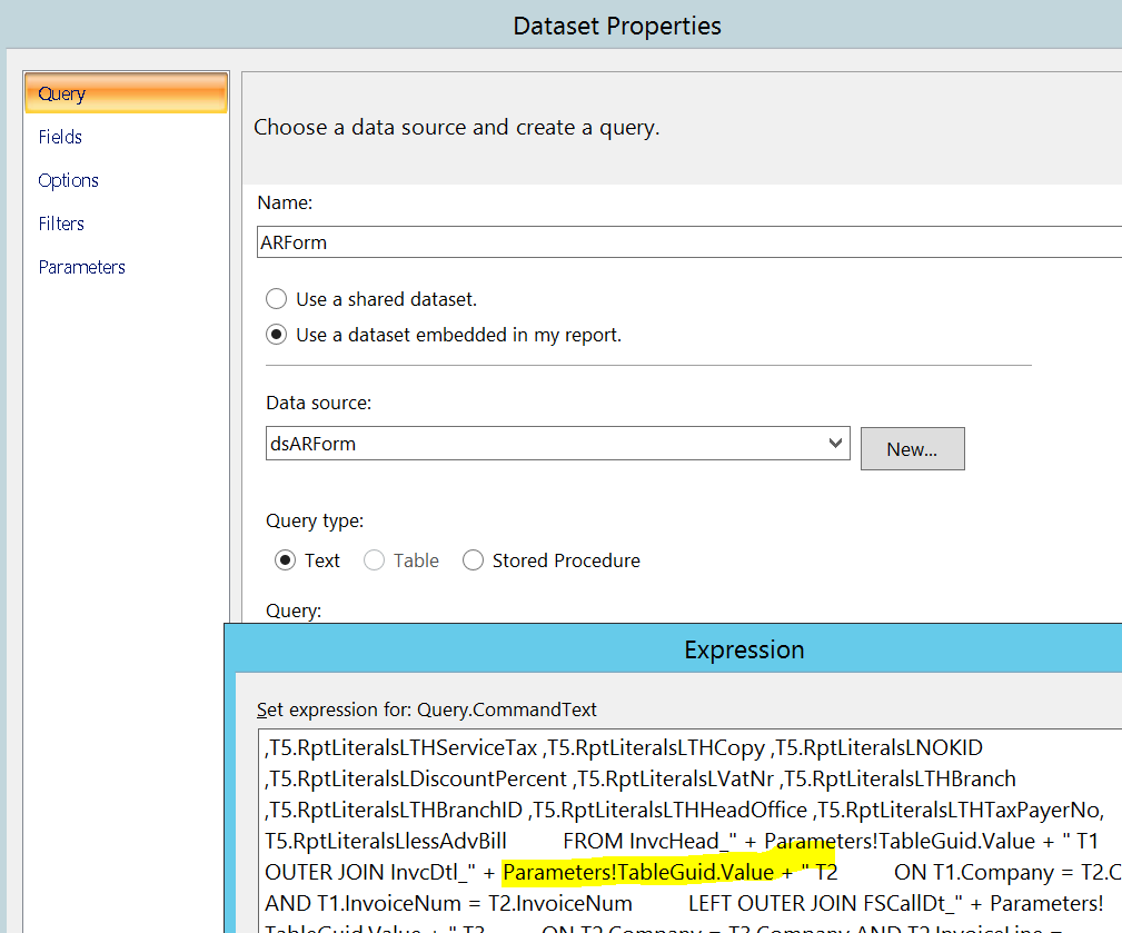

Glad your getting there - in order to test the SQL, copy the expression from the ARForm dataset in SSRS, open an SSMS session and paste it into a new query, replacing Parameters!TableGuid.Value with the GUID from system monitor.
omg… I forgot about this. I had mistakenly thought that a GUID only was generated when the report actually rendered. Which didn’t make sense given it’s just a data call.
PRO tip! Thanks
You’ll also need to clean up the expression as it is a formula that evaluates to a string. Take out the leading =", and any other areas that change from string to variable. Basically, replace
" + Parameters!TableGuid.Value + " with the GUID
so that
OUTER JOIN OrderRel_" + Parameters!TableGuid.Value + " T3
needs to be
OUTER JOIN OrderRel_0123456789987654321 T3
and remove the closing "
