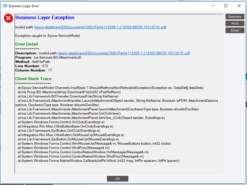

We just upgraded form 9.05.702A to 10.2.300.5 and I have strange issue with the attachments that were in E9 not opening in E10.
When I try to open an attachment that came over I get this error (we did not move or change the location of the attachment storage)
I can take the link and past it in windows explorer and open the file no problems. I am not sure why I have …pdf
I can successfully add a new attachment and open it fine.
Any thoughts why the old ones will not open.

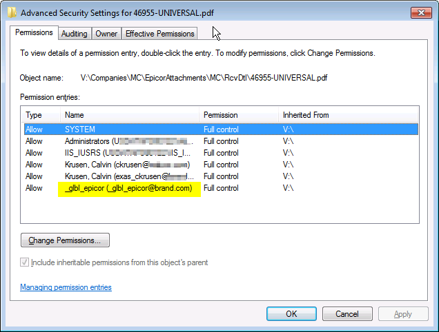

Does the E10 App Server have access to that share?
EDIT:
And not just to the share location, but permission at the file level (for all the pre-existing ones).
In Windows explorer, browse to that files location, and check the Security settings
The highlighted “user” is the one our App Servers used during their configuration
