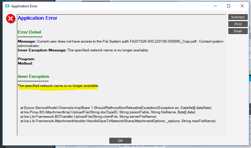

We have been attaching documents for years in Epicor and never had issues. I have one user (she uses this ALOT) that has started to have issues. I think this is more a network issue but not sure.
I even tested it and get the same error. It appears to be telling me that the path (network location) is gone…thoughts??
The odd part is it tells me it can’t attach the file but is shows up in the document attachment share.
If i try to open it is says file is damaged and could not be repaired.
That’s a permissions or network connectivity issue. Not an epicor issue. Maybe a bad network connection? or a bad Active Directory Relationship?

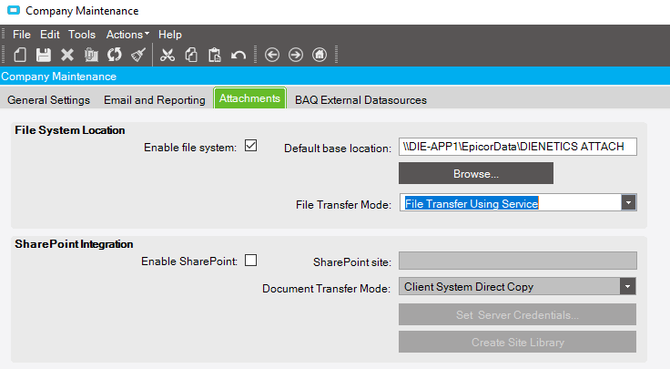

  • In Company Maintenance check the Attachment Path you have set, see if you can get to it.
  • If your setting is set to “File Transfer using Service” then make sure the Service Account that runs your IIS Poll can reach the Path. Perhaps its Password Expired.
  • If you are using “Client System Direct” then the users need to have permissions
  • You may have “File Transfer using Service” on Company Maintenance, but you can override that PER Each Attachment Type, make sure the Attachment Type they are attempting isn’t trying to use “Client Direct Copy” if you don’t have permissions setup for Clients.

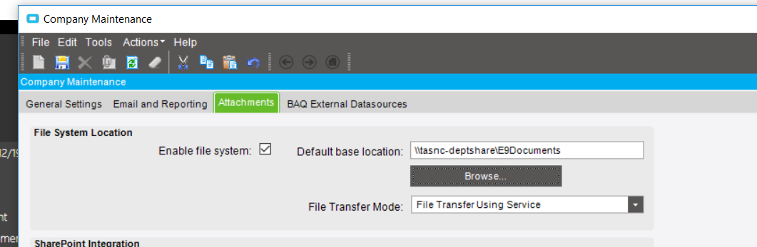

Here is the set up…
I can access that file location fine. I can browse the folder and open any file.
