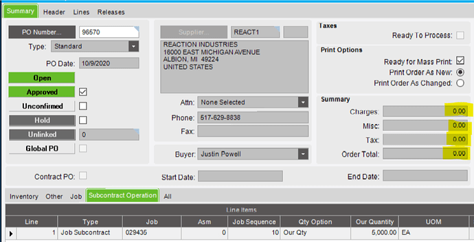

I may have spoke too soon. It approves, but I’m missing some data and it’s acting strange.
First, it allows me to uncheck the Approve box… Normally I get a box stating “Record in process, unable to update” when trying to uncheck approve; pictured below.
Secondly, on the PO entry summary tab, the summary is not being updated, pictured below:
The line\release has the expected results though:

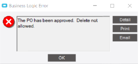

But if I try to delete the line, it does tell me the PO is approved and delete is not allowed:
Think I’m turning mole hills into mountains or should I not be concerned? Any ideas?
You don’t have that PO loaded in in PO entry when the DD runs, do you? If so, after the BPM runs, refresh the PO Entry form so that it has the latest data.
No sir, I’m opening the PO after the DD runs as the PO doesn’t exist until the DD runs.

If you stop the BPM before it tries to do the approval part, and then look at it with PO Entry, does the summary page show the correct totals?
Sure doesn’t, great… I’ll have to nail this down before I worry about the approval process.
I managed to get everything working correctly. I had to give up on the DD and move to a method directive. PO is created, everything looks correct and it’s being auto-approved.
