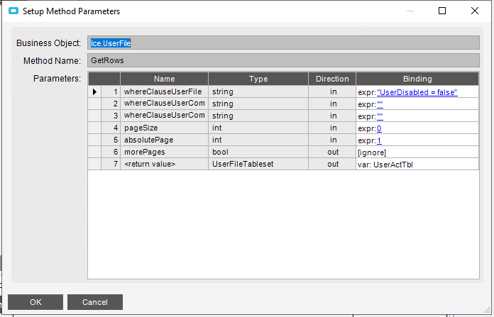

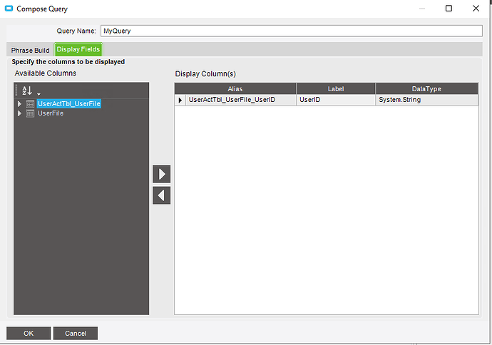

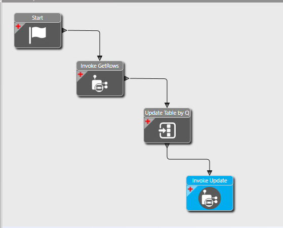

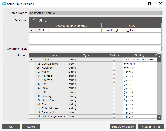

This is my function layout, I’m only using Ice.UserFile directives:
GetRows Parameters:
Query Setup:
Table Mapping:
When I debug by sending myself the list via email (info messages don’t seem to work when scheduling the function) the list gets generated, but when I add in the Update method it errors out with the above error.

I’m running it via “Schedule Epicor Function”, I have Security Manager access and the 3 Function Developer group permissions, and I only have one field in the “Update table by Query” block
Running the same query in a BAQ doesn’t show any null values for UserID, I filtered for UserDisabled = false on the GetRows where clause. Then on the “Update table by Query” I set UserDisabled = true and RowMod = U only for rows that have a “LastDate” greater than 3 months ago.

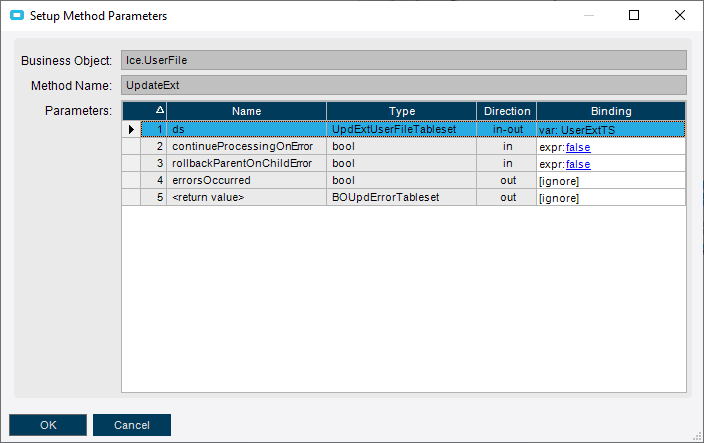

I ran into this same exact issue. I was able to resolve it by calling UpdateExt instead of Update. I’ve got this code block to populate the UpdExtUserFileTableSet just prior to the UpdateExt Widget.
var ufr = new UserFileRow();
ufr.UserID = userFileListTs.UserFileList[0].UserID;
//I run GetList prior to this to translate AD/SAM account passed into REST by our offboarding system to Epicor UserID.
//So there is a UserFileListTableSet with 1 row in it.
ufr.UserDisabled = true;
ufr.RowMod = "U";
userExtTS.UserFile.Add(ufr);
I am having trouble getting this to work with the UpdateExt method, I think it is because the query is based on the GetRows method which returns a a tableset with type “UserFileTableset”, while the UpdateExt method requires a dataset with type “UpdExtUserFileTableset”.

These are my parameters for UpdateExt:
My snippet was meant to be used in a system that was only going to send one term request at a time. For multiple users, you gotta loop it. Something like this (note: I have not tested this).
