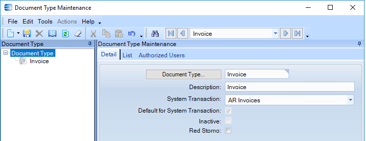

so apparently i had to created a Transaction Document Type for AR Invoices in order to get this to work. Unfortunately the error wasn’t helpful and tearing through the dll with reflector was required to get an idea of where it was failing.

I have the customer set and the order set for Auto invoice, but when I do a shipment I get an error stating ERS Document Type not valid.
Would you be able to provide a screen shot of what your Transaction Document Type screen looks like?
Thanks.
Brad
To clarify my setup question is regarding the System Transaction field. I set it to Packing Slip thinking that was the trigger to generate the ERS Invoice.
Is that correct?
Its AR Invoice and then attach this to Company Configuration Sales -> Order Tab.
Ah, the company config setup is what I was missing.
Thanks Rob.
