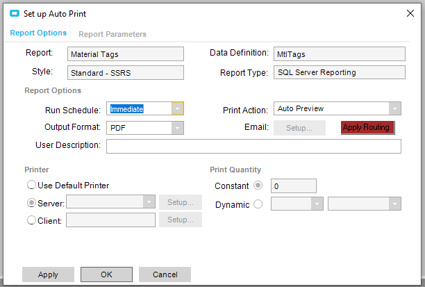

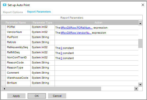

I have created a test AutoPrint BPM to test out auto print. I am getting no errors on save but it prints a blank page. Below are the settings for BPM. This is a standard Data Directive on RcvDtl

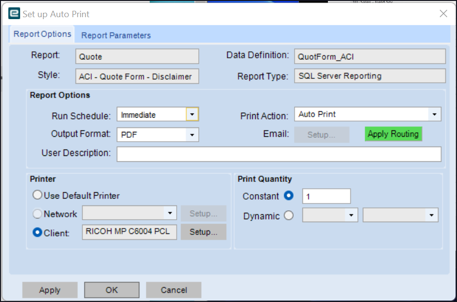

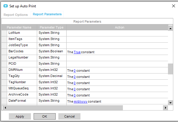

I just compared your screen to mine, and other than the printer, the only difference I see is I have a 1 in the Print Quality Constant field. Don’t remember what that does…but maybe that’s the issue?
EDIT: I think that’s the number of copies you want printed.
Thank you, I also have ours set to Auto Preview, I changed that field to 1 and we are still only getting blank pages.

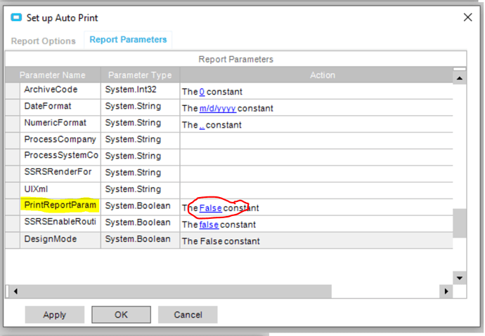

Here, in case you haven’t come across these yet:

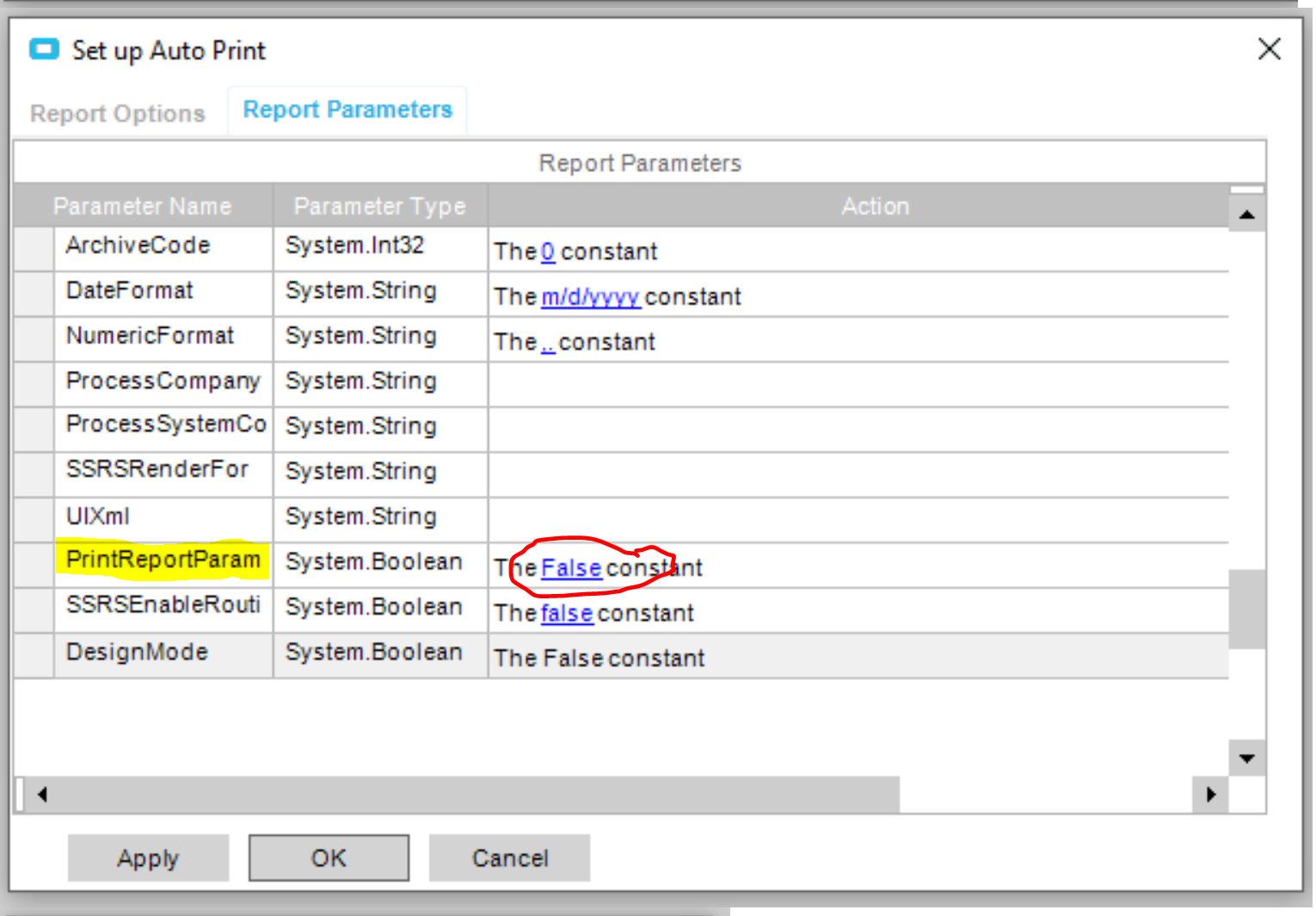

Just skimming the settings; have you tried to flip this one to “TRUE”?
I have made that change, but still prints blank PDFs
