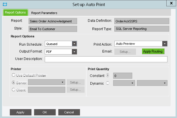

@bderuvo @timshuwy I have a breaking/routing on OrderAck for my ship ticket set to break on OrderNum. I setup the auto printing the BPM and it works, except it errors out as No OrderNum found. Have you ran across this? Am I breaking on the wrong piece? I figured the Ordernum would be the best way to break.
You need to change a setting the auto print rule. In the BPM designer, edit the options of the auto print action. Change the OrderNum parameter click the arrow on the right-hand side and select The specified table and field value.
Saw that right as you sent your message over! I’m a little slow these days! Thank you!
