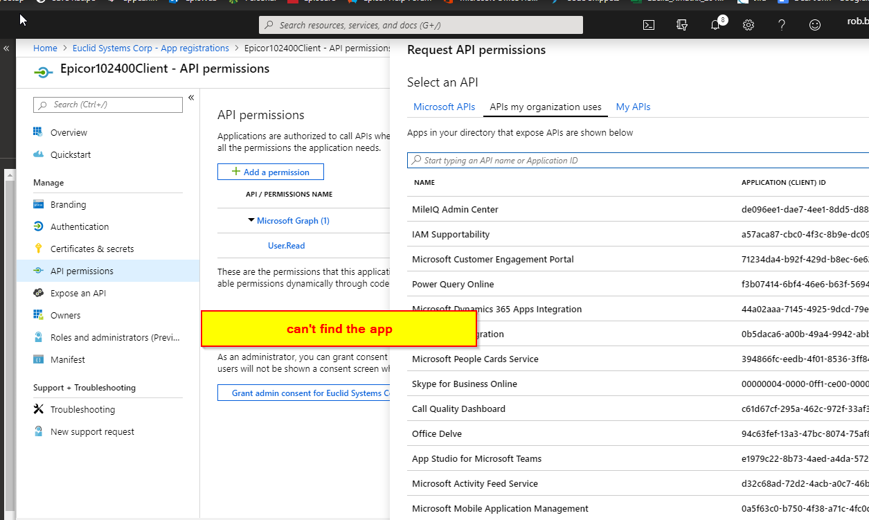

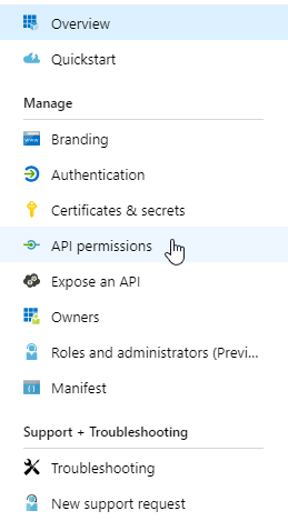

Any tips for configuring this on the Azure side? Documentation doesn’t match too well with what I’m seeing in my portal. I’m stuck here, trying to logon to the app server in the admin console… for the life of me i can’t figure out how these permissions are set.

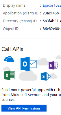

  1. Search for “App Reg” in the search bar at the top of the Azure Portal page and select App Registrations
  2. Select your application from the list of app registrations.
  3. View/Edit the API permissions associated with the app.
i think that’s the underlying issue, i don’t see it in there. Not sure how to get it in there at this point.

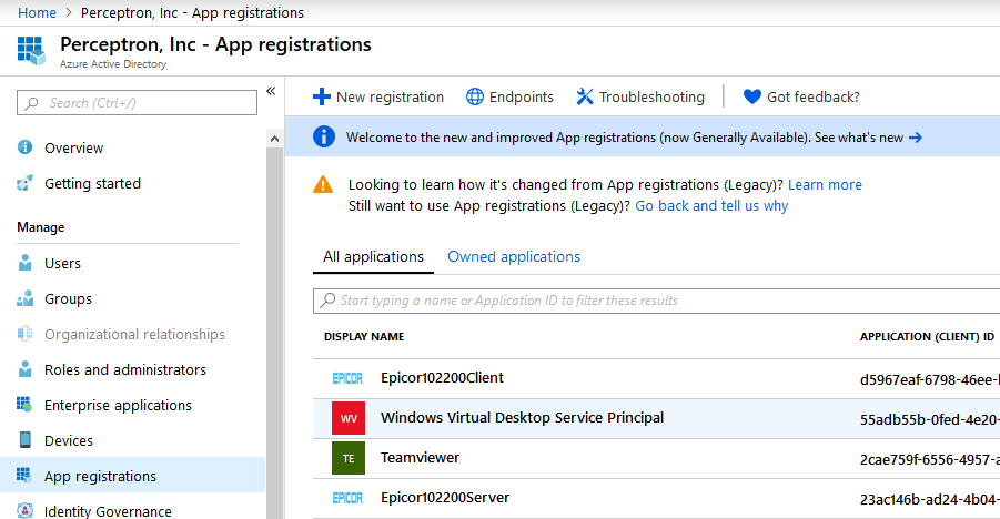

In our Azure AD, I found it under App Registrations:
i see mine there too, but i still get that error

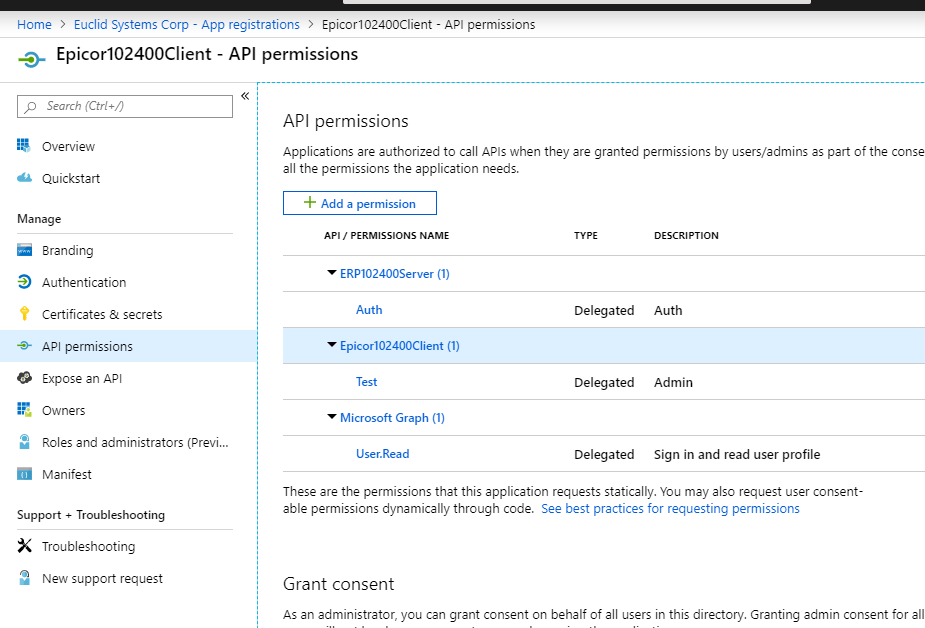

And when you click the App Registration, what do you see when you check the View API Permissions on that page?

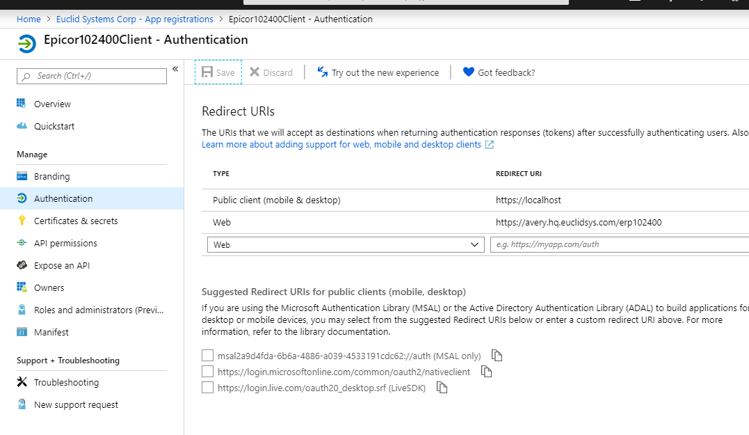

after fooling around i was able to get these in there, tho i think the client is unnecessary? I’ve migrated to a new error at least :slight_smile:
i think i got it…

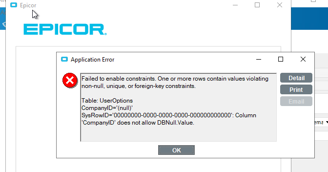

i can log into the client using main menu and azure AD, but if i try shell or home page i get the following. Has anyone seen this?
figured it out, thanks to @Hally and his post 10.2.400 New Install Gotcha's - #7 by Hally
