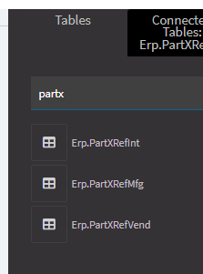

There is a table called “PartXRefInt” (part x reference internal) that holds the data. (there are two other similar called PartXRefMFG and PartXRefVend which you could also check)

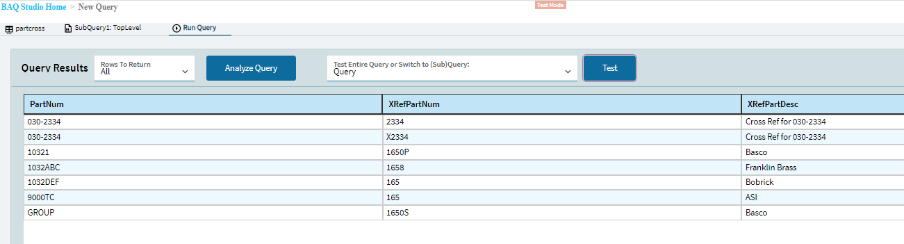

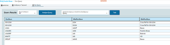

I created a BAQ to show all the data in my PartXRefInt… you can show both the real and the cross reference part. I would add a filter and select your special part above to see if there is a blank cross reference against it.
Hi Tim, that was the guidance I was looking for. I queried the 3 tables. PartXRefInt and PartXRefMfg have 0 records. PartXRefVend has 1,629 records, but none of the parts are blank. There are no records with “STCT” in the part number fields (there are 3 of them). Checked them all.
