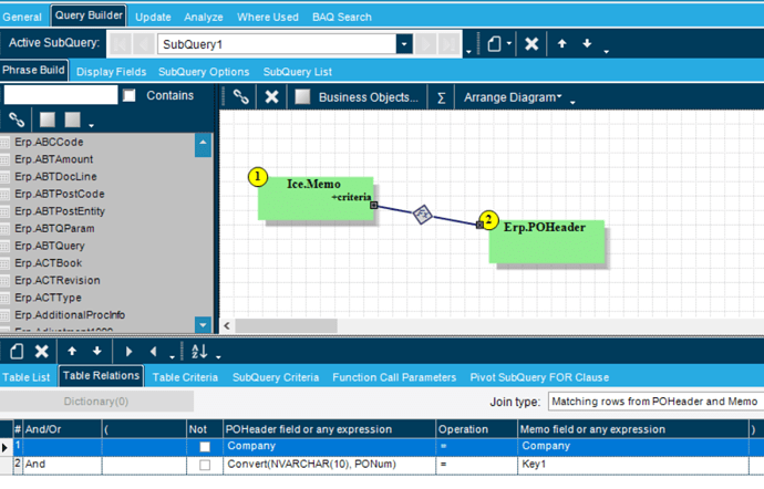

We had the problem because of a BAQ where we were joining Memos to POs. Memo Key1 is string and PO is integer so we had to write a convert function to fix the issue.
