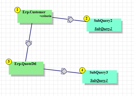

BAQ Error "Bad SQL"
I have a BAQ, it finds customers with no orders, then for these customers it finds their quotes, and then gives the win/lose reason code from the task tree. If I delete block 4 (the task/reason) it works. Or if I change the join from 3 to 4 to in inner join it works, but then quotes without a task completed do not appear in the results.
Analyze finds no problems, it only gives a “Bad SQL” error when you actually run it. I have attached the actual BAQ and screenshots.

where (Customer.EstDate >= @StartDate  and Customer.EstDate <= @EndDate)
 and (SubQuery2.OrderHed1_CustNum is null)

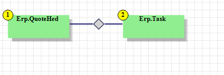

I think I might have found another problem? This super simple one also gives a bad SQL error and it has no join with customer…
select
	[QuoteHed].[QuoteNum] as [QuoteHed_QuoteNum],
	[Task].[TaskID] as [Task_TaskID],
	[Task].[TaskSeqNum] as [Task_TaskSeqNum],
	[Task].[TaskDescription] as [Task_TaskDescription],
	[Task].[Conclusion] as [Task_Conclusion],
	[Task].[ReasonCode] as [Task_ReasonCode]
from Erp.QuoteHed as QuoteHed
inner join Erp.Task as Task on
	QuoteHed.QuoteNum = Task.Key1
in 10.2.400.10 worked no error.

These types are different. Should you not cast the QuoteNum to varchar?
I’ll try that now, but @hkeric.wci didn’t have to it seems.
Yeah, I saw that. Strange. Whenever I connect an integer to one of those KEY# fields, I usually cast it.

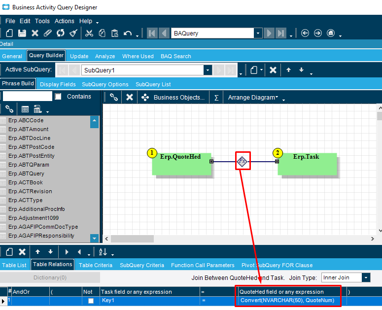

Hi Evan,
Task.Key1 is NVarchar(50) and QuoteHed.QuoteNum is Numeric.
So you need to cast the QuoteNum as NVarchar(50) to make it similar to Task.Key1
On your BAQ you should have something like this:
select
Task.Key1 = Convert(NVARCHAR(50), QuoteNum)
So on the inner join definition, add the following expression: Convert(NVARCHAR(50), QuoteNum)
Ah, that is a better way of doing it. I made a sub query with a calculated field and then joined with that, but your way looks less messy.
