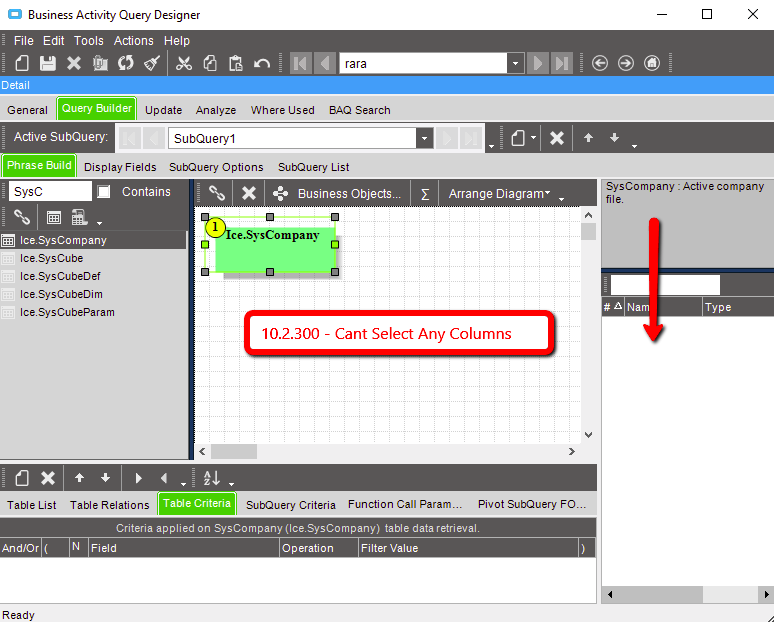

On another note you can no longer use the Ice.Sys* Tables in 10.2.300 – the columns come in blank for:
  • Ice.SysCompany
  • Ice.SysExtCompany
  • Ice.SysFiscalCal
  • Ice.SysFiscalPer
  • Ice.SysFicalYr
  • Ice.SysPlant
  • Ice.SysUserComp
  • Ice.SysUserCompExt
  • Ice.SysUserFile
This may be probably by Design; Because there are other Aliases we should be using such as Erp.Company, Erp.UserFile… unfortunately those dont have all the columns.
It seems to be because 10.2.300 adds “zf.SystemCode = it.TableOwner” to its Query, which those Sys tables fail.
2019-05-06_1016
You might wonder which Columns one could need from Ice.SysCompany
SMTP or DefaultLabelPrinter seem to be used by folks, when they create their own “BarTender” Auto-Print like UD01.
I still got it to work by adding the Column in a Calculated Field and just hardcoding the Ice.Table.Column in the JOINs.
2019-05-06_1015
