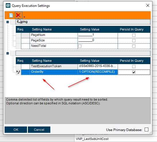

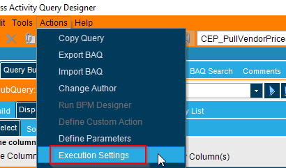

Ask @jgiese.wci what a difference a statistics update can make. We’ve both been blow out of the water before. Also you may have old / cached plans on this BAQ in SQL you can change that by adding an OPTION(RECOMPILE) at the bottom of the query. This is kind of tricky to do, but if you don’t have an order by clause then go go
This forces SQL to ditch its old Plan and generate a new one. You pay for it a little by having to generate a new plan but the cost is small compared to the 100X you are seeing now.
