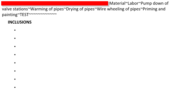

Working on an SSRS report in Microsoft Report Builder and having trouble with a one-dimensional array. This all stems from using a configurator in our quoting process. We have data we want to send to the report, but the configurator sends it as an XML file, which limits us to 50 characters. To get around this, we’ve started writing the data to a UD field separated by “~”. In a calculated field within the report, I use the Split() function to create a one-dimensional array with all of the values (currently includes blanks, but can get around to that later).
The issue I’m finding is that when I try and use grouping to loop over the array, it just prints out a blank value. I can grab individual values just fine if I use Split(Fields!BigString.Value, "~").GetValue(x) but each UD field could be made up of 20 different values (will be different for various configurators) so that’s not a very feasible option. I was expecting to just be able to declare that calculated field and then type that into the expression, but are there more steps I am missing? I am showing the big string above so I know there are values, but below that is where I’m trying to display each of those values in a bulleted list.

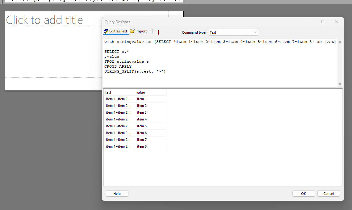

Try to make this thing all one line, with each word in your select statement only separated by a space.
You see this? We can tell this is going to work, because we can do it in a designer and it’s working fine.
You can see that I made up some random field like yours and then ran that same sql logic with the cross apply and you see I get a row for each item like you wanted.
Putting it in as one line seems to have gotten the query to work! Although when I print it out, it just repeats the first entry
But that example you show is exactly what I’m looking for!
