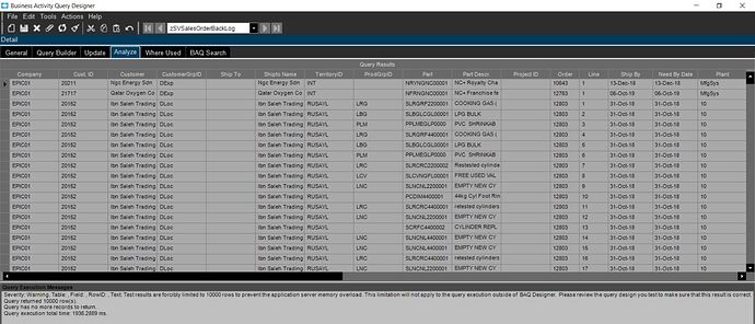

@swetadafle, I have run this query in our environment (version 10.2.100.9) and it is working fine for your reference screenshot is attached below
Check if it is not shared for all company. This is system BAQ. You can try copy BAQ and tick Shared + All Company to check again.
