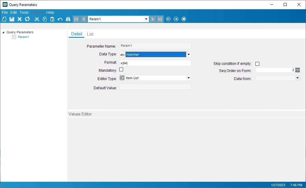

In the BAQ define go to Actions, Define Parameters.
Select New, Type your parameter name, and choose Editor Type–>Item List.
Save.

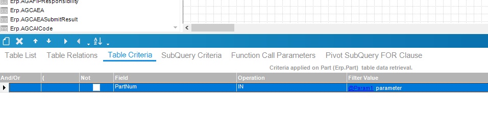

In the criteria section at the bottom on the query you want, add a criteria for partnum.
Then select Operation IN, and “specified list parameter”, click the blue “specified list”
section, and choose your parameter.

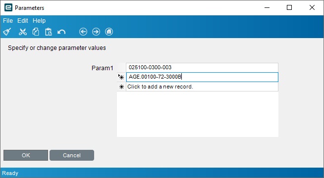

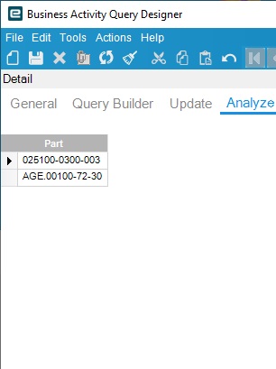

Save your BAQ and run it. It will give you a prompt to add your criteria to the list.
