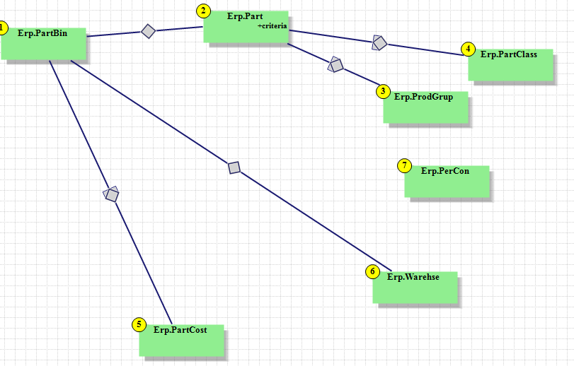

Hello,
I would like to have the Buyer name and ID on this BAQ I have. I did not make this BAQ. I can connect via Company and I do get the Buyer ID and Name in my results, but it is also giving me a “Severity: Error, Text: Bad SQL statement.” warning and I have to ‘x’ it otherwise it just hangs. Any advice? What is wrong with my connections?

your error is due to incomplete setup either on a join or selection criteria.
like @knash said, what condition is currently on your part table? Do you have any incomplete relations setup between tables?
I would remove the PerCon table - it’s not joined to anything an would be creating multiple rows.
Assuming you are single Site - Join the PartPlant to the Part and link the with an inner join PurAgent
Bring in a second purAgent table and inner join it to the PartClass

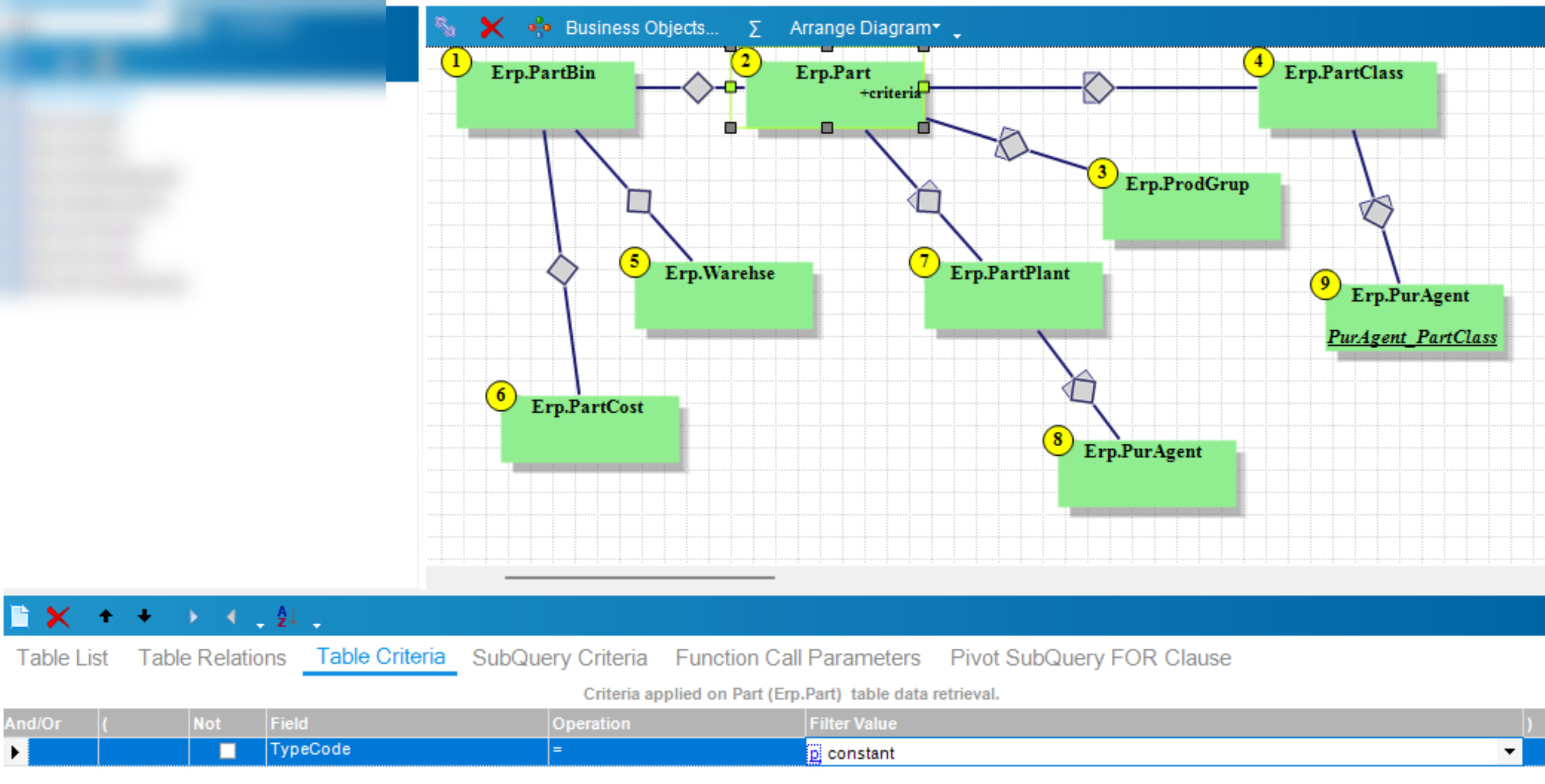

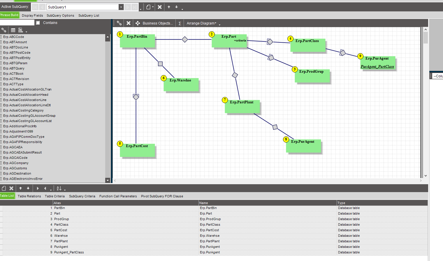

Do you have PurAgent outer joined twice like @LarsonSolutions showed it?
If so then one of them will have an alternate table name. They just add a 1, but you can also make it more descriptive like he did PurAgent_PartClass.
The one from PartPlant will be first then the one from PartClass.
I think it works! Thank you very much everyone.

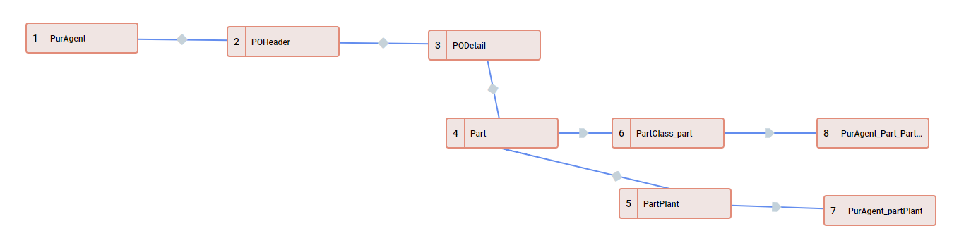

@mlp - if you want to know who is buying the materials, you need to add in PO tables
This query below would show who the buyer is that is buying a part vs who “should be” based on the part class or Part Plant tables.
OK. I tried that but I am having difficulty weaving it in with the other tables I need.
What I have now is okay, it being pulled from the Part Maintenance to tell me who the buyer is. This is a BAQ made by someone else that I am trying to add the Buyer information.
But we noticed that I am still getting duplicates for other columns, this time when it concerns the Bin. Which messes up the calculation.
StockValTest2.baq (40.3 KB)
select
	[PartBin].[WarehouseCode] as [PartBin_WarehouseCode],
	[Part].[PartNum] as [Part_PartNum],
	[Part].[PartDescription] as [Part_PartDescription],
	[PartBin].[BinNum] as [PartBin_BinNum],
	[PartBin].[OnhandQty] as [PartBin_OnhandQty],
	[PartCost].[StdBurdenCost] as [PartCost_StdBurdenCost],
	[PartCost].[StdLaborCost] as [PartCost_StdLaborCost],
	[PartCost].[StdMaterialCost] as [PartCost_StdMaterialCost],
	[PartCost].[StdMtlBurCost] as [PartCost_StdMtlBurCost],
	[PartCost].[StdSubContCost] as [PartCost_StdSubContCost],
	(PartCost.StdBurdenCost + PartCost.StdLaborCost + PartCost.StdMaterialCost + PartCost.StdMtlBurCost + PartCost.StdSubContCost) as [Calculated_TotalCost],
	(PartBin.OnhandQty * TotalCost) as [Calculated_Value],
	[ProdGrup].[Description] as [ProdGrup_Description],
	[PartClass].[Description] as [PartClass_Description],
	[Part].[TypeCode] as [Part_TypeCode],
	[ProdGrup].[ProdCode] as [ProdGrup_ProdCode],
	[PartClass].[ClassID] as [PartClass_ClassID],
	[Warehse].[Plant] as [Warehse_Plant],
	[PartCost].[LastLaborCost] as [PartCost_LastLaborCost],
	[PartCost].[LastBurdenCost] as [PartCost_LastBurdenCost],
	[PartCost].[LastMaterialCost] as [PartCost_LastMaterialCost],
	[PartCost].[LastMtlBurCost] as [PartCost_LastMtlBurCost],
	[PartBin].[Company] as [PartBin_Company],
	(PartBin.OnhandQty * PartCost.LastMaterialCost) as [Calculated_TotCost],
	(Coalesce(PurAgent.BuyerID,PurAgent_PartClass.BuyerID)) as [Calculated_Coalesce],
	[PurAgent].[Name] as [PurAgent_Name]
from Erp.PartBin as PartBin
inner join Erp.Part as Part on
	PartBin.Company = Part.Company
	and PartBin.PartNum = Part.PartNum
	and ( Part.NonStock <> 1  )
left outer join Erp.ProdGrup as ProdGrup on
	Part.Company = ProdGrup.Company
	and Part.ProdCode = ProdGrup.ProdCode
left outer join Erp.PartClass as PartClass on
	Part.Company = PartClass.Company
	and Part.ClassID = PartClass.ClassID
left outer join Erp.PurAgent as PurAgent_PartClass on
	PartClass.Company = PurAgent_PartClass.Company
	and PartClass.BuyerID = PurAgent_PartClass.BuyerID
inner join Erp.PartPlant as PartPlant on
	Part.Company = PartPlant.Company
	and Part.PartNum = PartPlant.PartNum
inner join Erp.PurAgent as PurAgent on
	PartPlant.Company = PurAgent.Company
	and PartPlant.BuyerID = PurAgent.BuyerID
left outer join Erp.PartCost as PartCost on
	PartBin.Company = PartCost.Company
	and PartBin.PartNum = PartCost.PartNum
inner join Erp.Warehse as Warehse on
	PartBin.Company = Warehse.Company
	and PartBin.WarehouseCode = Warehse.WarehouseCode
order by Warehse.Plant, Warehse.WarehouseCode, Part.PartNum
If you have multiple bins then you will need to make the qty a subquery grouped by company and part or use PartQty instead.
