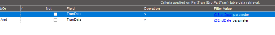

Where PartTran.TranDate < @StartDate AND PartTran.TranDate > @EndDate
This gives me zero records.
That should be an or, not and and
. edit actually the ranges should be switched.
I just tried this and i think it worked:
Where PartTran.TranDate < @StartDate AND PartTran.TranDate < @EndDate
That’s going to give you everything less than the end date.

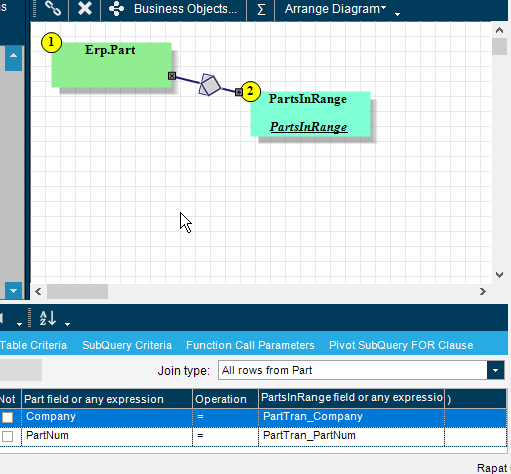

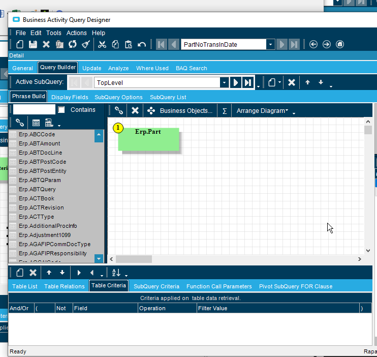

Here’s a sample BAQ that uses a left join. Anything in the top level with the subquery results coming back as empty are the rows that you want.
An Except query is going to be cleaner/better, but is sometimes harder to trust since you don’t see the empty cells.
Okay i think i got it this time.
This will give me transactions that do not show up within the date range.

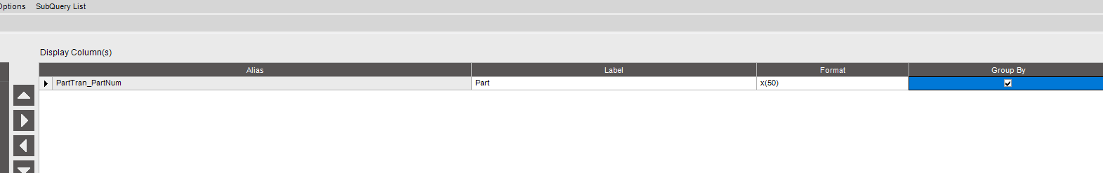

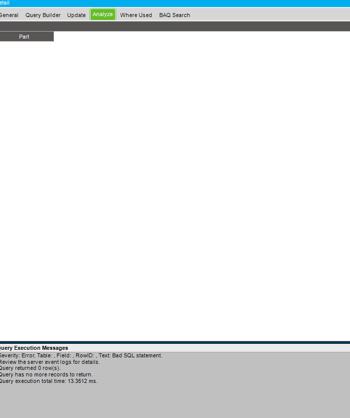

So my next question is. Why do i get a Bad SQL error when i group by part num?
Can you paste in your whole SQL statement?
select
	[PartTran].[PartNum] as [PartTran_PartNum]
from Erp.PartTran as PartTran
where (PartTran.TranDate < @StartDate  or PartTran.TranDate > @EndDate)
group by [PartTran].[PartNum]
order by PartTran.TranDate
its the “order by”. Dang i knew it when i saw the code.

You actually want to start with a list of everything that IS in that range. So switch your <> around.
so if heres if your set
a= 1
a = 3
a = 5
b = 1
b=5
You end up with this
a=3

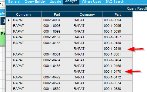

Now on different level you get all of the possible parts (use the part table) you get this.
a
b
then you join those 2 together but you use a left join so you get all of your possible parts.
all parts | parts in range
a ________a
b
Notice that b is empty in the second column. That signifies what you are looking for.
These are my parts that aren’t in my date range.
That’s the join you need to make.

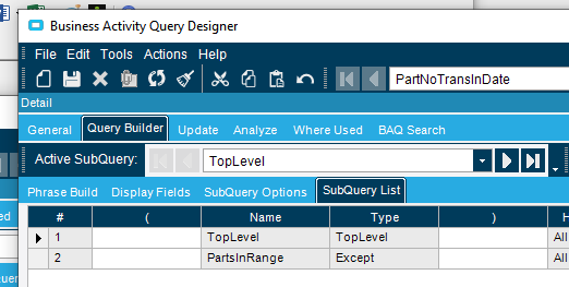

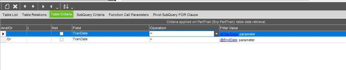

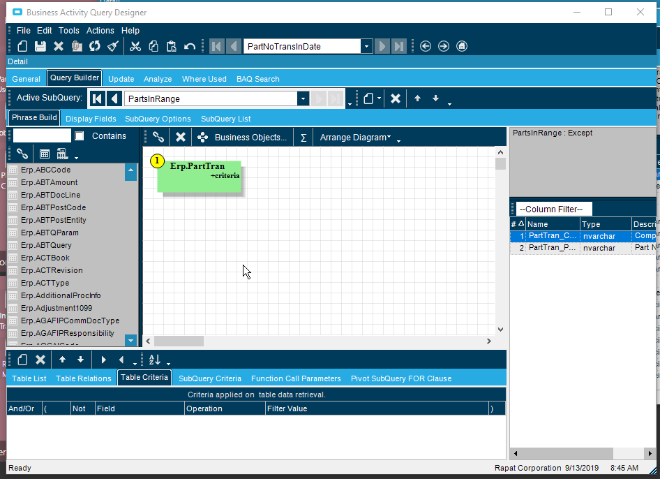

The other (probably better) way to do this is to use the except query. It’s a little pickier on the setup, but it works like this.
You except level is the PartTran table with the criteria and the grouping.
Your top level is just the Part table.
Both queries have to display the same number of field for this to work, and your order of tables need to be as shown.

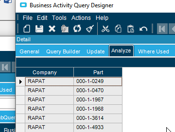

When you are done, you just end up with this. Notice, those first two numbers are the one shown in my earlier screen shot. The except query displays only what you want, but, like I said, it’s a little harder to check/trust if you have a logic problem somewhere in your query so many people don’t like using it. (I rarely use it myself)
