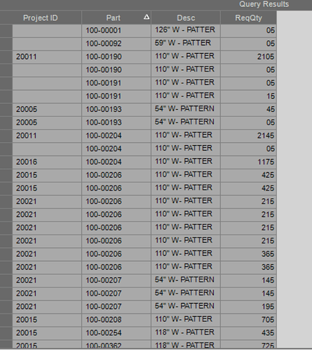

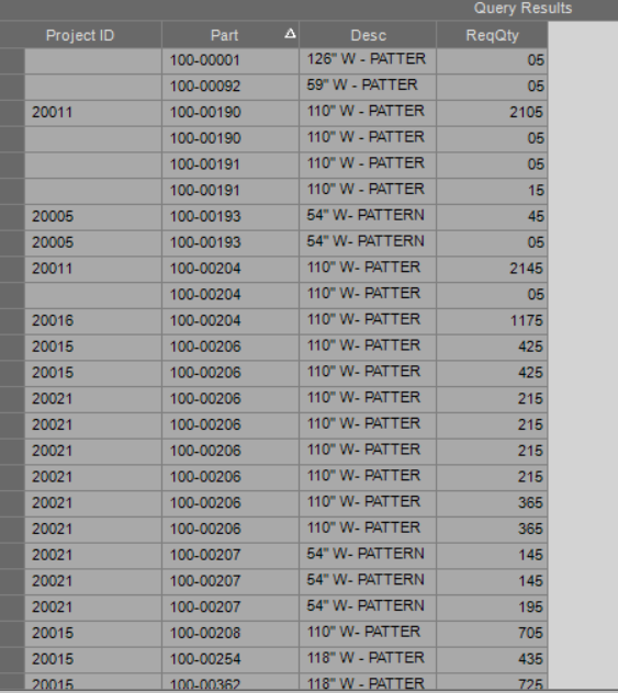

I have a BAQ that is pulling the Project ID, Part Num, Part Desc and a calculated field for ReqQty. I would like the ReqQty to rollup grouped by Project ID and Part Num to only show one line instead of multiple. Is there a quick way to get that to happen? I tried grouping the Project ID, Part and Desc fields but there was a Bad SQL statement error
