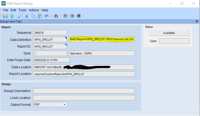

Mike, I was JUST looking for this same thing. Not sure if this will work for you… it doesn’t for ME, but I’m SaaS and it may be a cloud/access thing. If you’re on-Prem, perhaps you can edit it…
From BAQ Report Designer > Load your target Report ID
Actions > Preview Classic Form
On the “Preview” screen there is an icon to “Generate for Design”.
After that, open your System Monitor… highlight the BAQ Report that was generated.
Actions > Design SSRS Report
SSRS Report Designer opens to show the details:
The highlighted text is (from what I can tell) what becomes the end PDF file name + (underscore) + the “Sequence” number in the first field of this form.
Again, this is all grayed out for me… but that could be because I’m a cloud customer. If you’re on-prem, you MIGHT be able to edit this??? I’d be interested to learn if that’s the case.
This is the only place I’ve stumbled on to anything that even closely resembles the end pdf file name.
I got this screen to pop up and same here that field is subdued.
I am going to chase this in the Report Data Definition and see what I can come up with.
