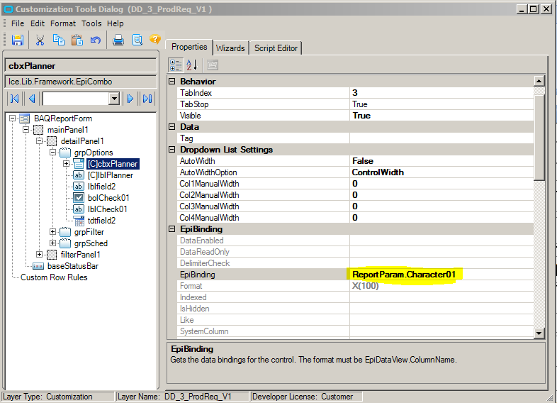

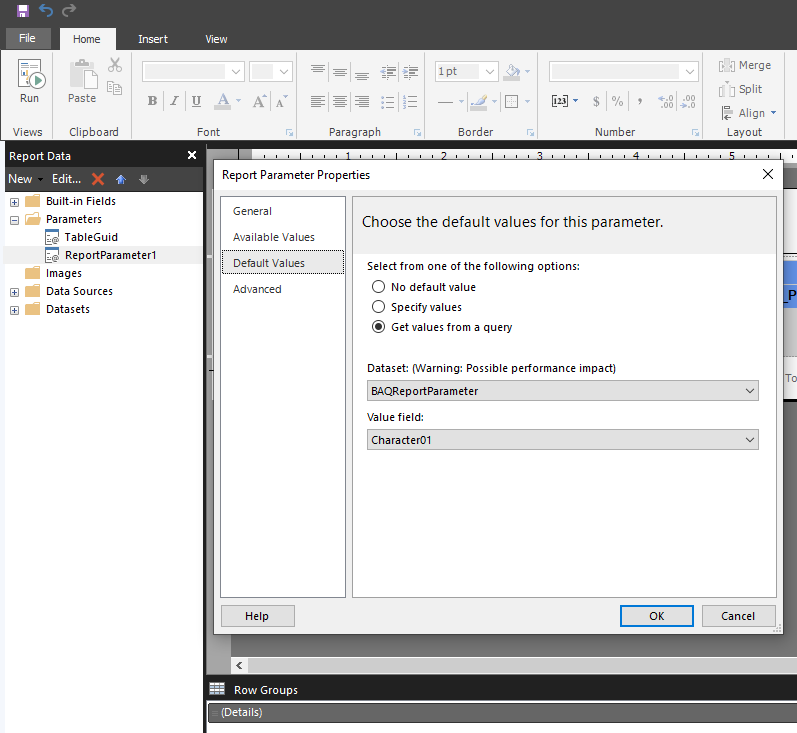

I tried binding the Combo box to The CallContexBpmData and could not get that to filter the dataset. All I could access was First(Character01). I wound up using ReportParam.Character01 from the EpiBinding section of the ComboBox and was able to use that as a Parameter for the SSRS Report and it will filter the report by the correct Planner ( in this case) . Are there any unseen implications from this ??? Anybody ??

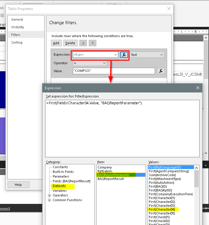

So I am having an issue getting the Filters to work. I think I am following how you have it layed out, but they are not working at all.
Adding a couple images:
EDIT
Whoops … I don’t think you can use aggregate functions in a table filter like shown below. Might need to edit the dataset’s query expression.
end edit
I don’t think you need to create the parameters in the RDL. Just refer to the field that’s already in your dataset. Might need to refer to the field with FIRST(...)
Like in a Tablix’s Filter property:
Not understanding what you are saying. Please explain.
Plus in the end, I will have 3 ReportParameters as filters.
I won’t bother explaining, be cause it won’t work…
But I’ll try to explain what happens when you have a value in that dropdown…
All it does is set the value of BAQReportParameter.Character04 (I’ll refer to it as BRP.Ch04 for brevity) to the value of the dropdown. This has no effect on the data actually generated. But BRP.Ch04 maybe able to be used in various parts of the report…

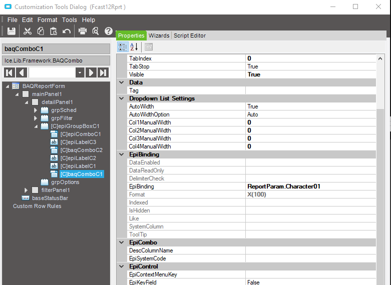

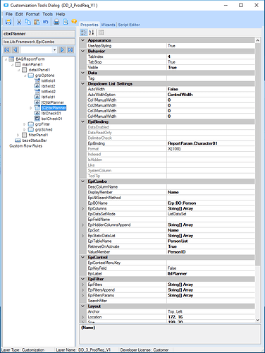

What do you have as your combo Box settings , this is mine to choose the planner, gives dropdown values for the Combobox Edit: The BO to pull the lost from, oops List from

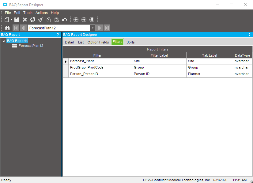

I’ll second Calvin’s suggestion, All the screenshots I have shares are driven off of creating a BAQ, THen a BAQ report ( executed through BAQ Report Designer) That is where you set your filters and options. The customization uses the BO.Objects to populate the comboboxes with the choices .

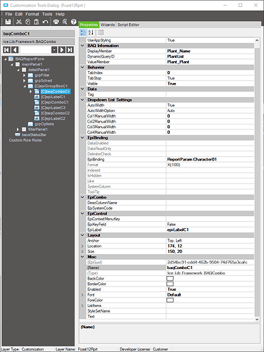

It is a BAQ Combo Box:

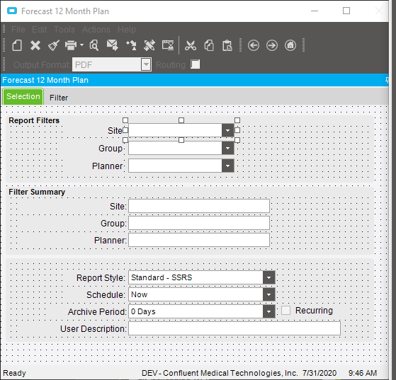

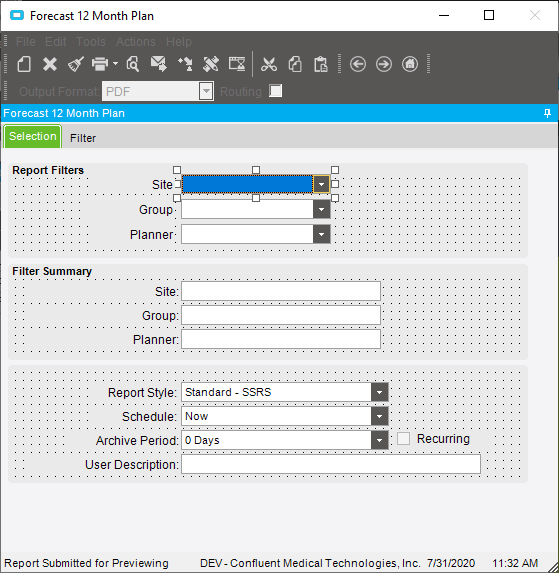

Yes my goal is to have the Site, Group, and Planner Filters setup as Filters, but I specify through a BAQCombo query the options and I also have an EpiCombo query for one of them. But I want to be able to have this as a dropdown on the Report form to filter the results. Currently the filter piece does not work.
I used an EpiCombo, not a BAQCombo. Not sure of use for BAQCombo
I think this all makes sense but I am not getting it to work still.
I did get this to work. I went back and just used Option fields but need to Customize them for Dropdowns. Thanks for your help. The key was that I was originally using ReportParam.Character01, but changed that to ReportParam.Field01 and now it is working. Thanks.
