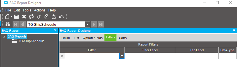

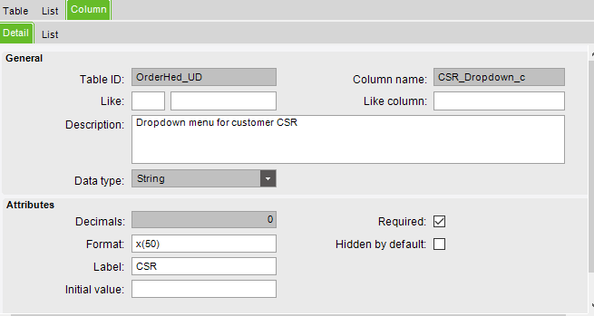

So yes, I have a UD field that holds the name of the customer service rep on our orders. They want a custom scheduled shipment report that they can filter by CSR. As an aside, I could not use the userID field as we often have non-CSR’s sharing the data entry workload so a UD dropdown field was my next best idea.
Sticking with the low IQ theme I have running here, I’ll just grunt and point at images :rofl:
I would like this field:
Here:
As interesting as it would be to learn how to do this, I think I can accomplish the same result with an option field in this case. I’m just going to go with initials instead of full name in the dropdown and the CSR’s can manually type their initials if they want it ‘filtered’.
