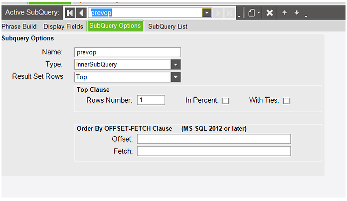

Look at the second link. Set up your sub quer(ies) with the results set like below. Then instead of joining it like a table, make the joins in the SubQuery Criteria. Then make a calculated field with the results of the sub query. You will have to make a sub query per item you want to show (one for vendor, one for vendor part number) because it can only return one column per sub query, but it will get you just the first record.

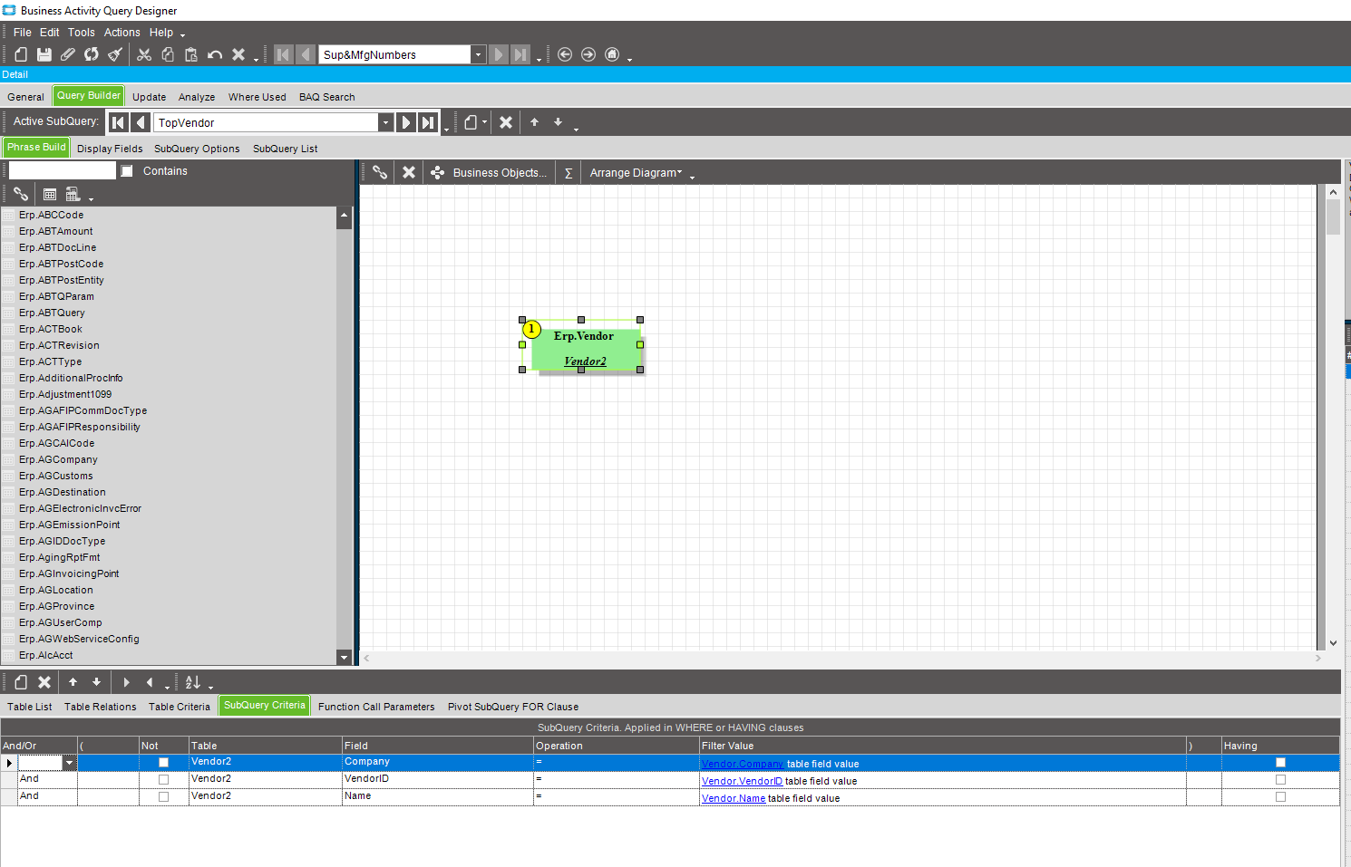

Can you show me a screen shot of your top level and your calculated field. I have theories, but I want to see what you have going on first.
Here you go. I’ve only done the Vendor name for the calculated field.

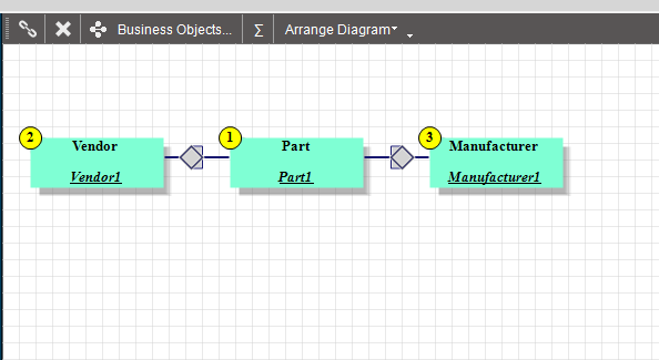

You don’t need the vendor in the top level and in the subquery. The joins that you are trying to make in the screen shot above is replacing the joins that you have set up in the top level. Your are having problems because you are just joining a duplicate table to itself. (you shouldn’t have vendor = vendor anywhere.) Your joins should be vendor to part table, and your top level should only have the part table, and the subqueries should have the vendor and manufacturer table.
Also, you only have one field in the display fields of the TopVendor query right?
