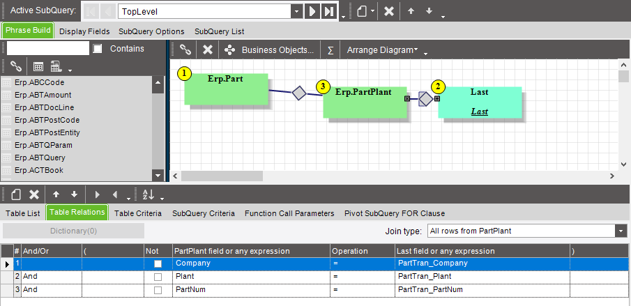

How do I link the two queries? LastPurchasedE10.baq (30.9 KB)
I attached my BAQ for reference. Here is the screenshot:
I believe I have this solved.
If it helps anyone, here is the query. It defaults to Current Company and Current Plant for Performance.
LastPurchasedE102.baq (43.1 KB)
