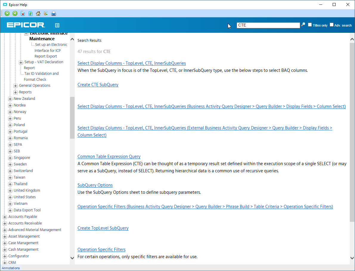

F1 (Help) in the baq screen has a very thorough example of how to do this and generate a multi level bom

Apologies I’ve looked through the help files but I can’t find an example that helps me with this problem. I’ve been looking through:
Epicor ERP User Guides > Tools User Guide > Business Activity Queries section
Am I looking in the right place?

It’s in the Epicor Help F1 (File -> Help)
