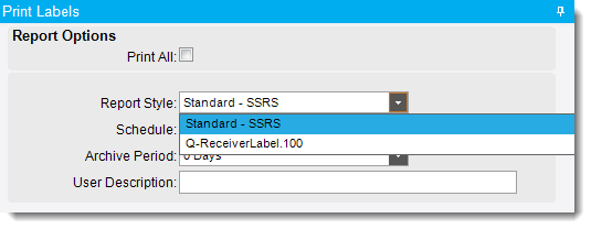

Negative. We had created a Report Def/Report Style that points back to a BT template we designed. So, in the Epicor “Print Labels” dialog, the user will see, by default, the correct report style to select. Once that is selected, Epicor shells out to the Windows OS print dialog in order to choose the label printer destination.

I may be referring to something completely different, but the the resulting Report Style (we called this particular one a “receiver label”) is available in that dialog, like so:
receiver-label
As mentioned, this does print on my own workstation label printer – but not if that same report style is selected by someone working from a completely different workstation. Their print job also gets printed on my label printer - not their own.
