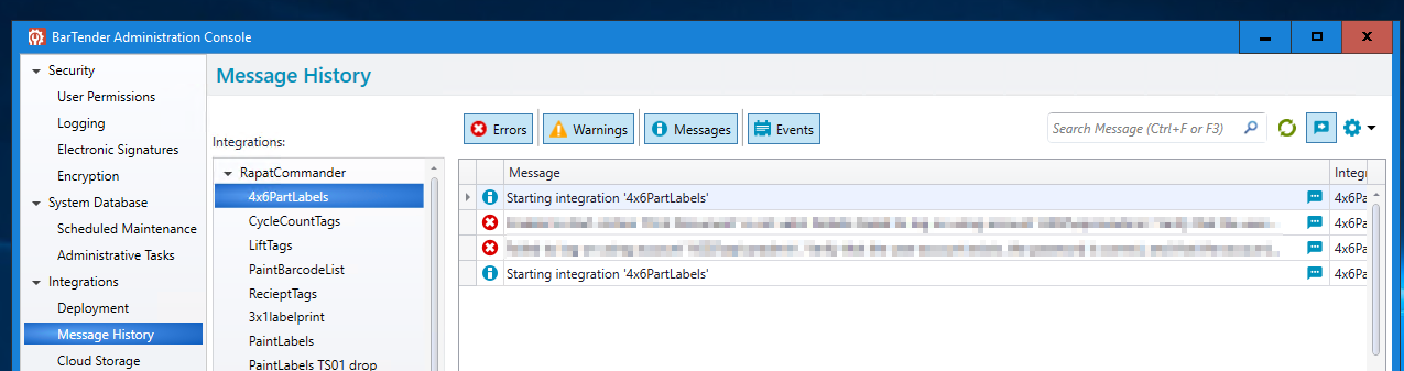

You should be able to go to your server that bartender is on and see some messages on the processes (assuming that you are on the newer versions of bartender). Can you look there and see if that gives you some clues?
Interesting…I do not have that console…
You might have an older version. It’s not called commander anymore. But I still believe it’s a problem with the file setup not recognizing the file the right way. It’s probably something minor. Also, bad characters can cause problems with bartender so try with some different data, or check the file in notepad++ and look with all characters on and see if you see anything goofy.
