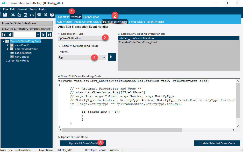

First make the FKV view with the Tools > Data Tools menu (see my screenshot from above). Once you have the data view setup use wizards > Form Event Wizard to add the view to the code

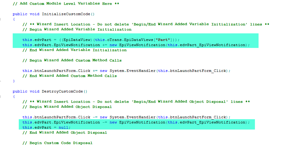

When I clicked Update All Event code, in the Script Editor, Epicor automatically added the code to make edvPart available as a class variable we can use in other parts of the customization.
Highlighted here in green:
