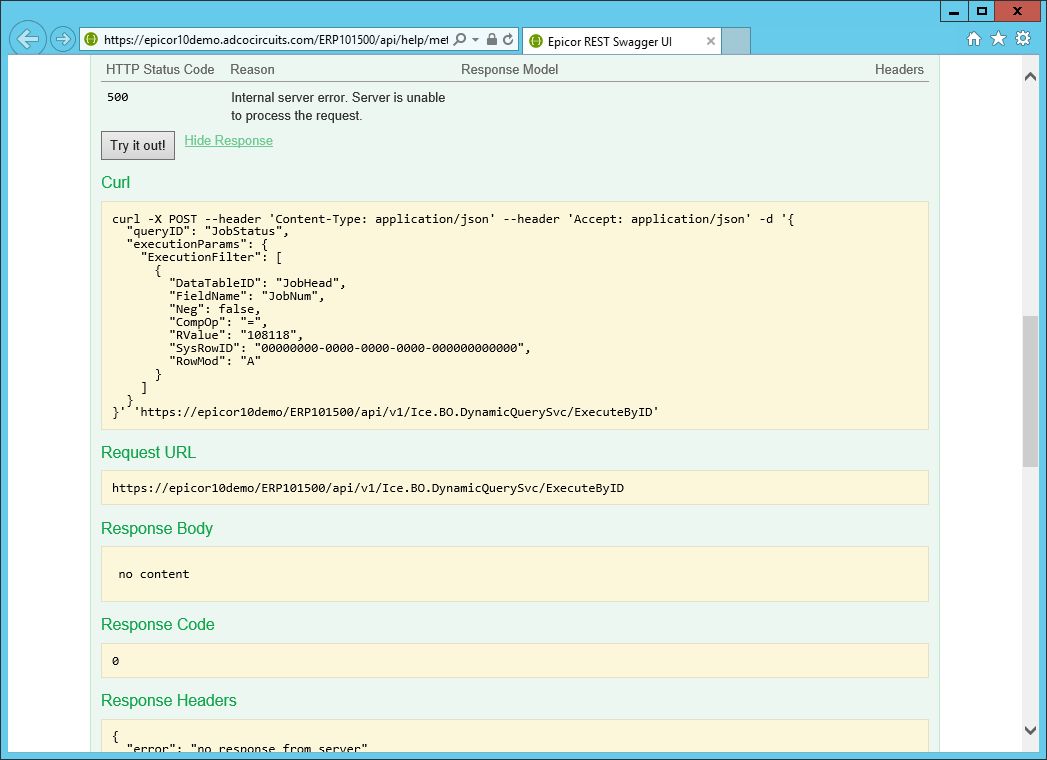

So I tried that for a simple query and got no where :frowning:
§ Curl
§ curl -X POST --header ‘Content-Type: application/json’ --header ‘Accept: application/json’ -d '{
§ “queryID”: “JobStatus”,
§ “executionParams”: {
§ “ExecutionFilter”: [
§ “DataTableID”: “JobHead”,
§ “FieldName”: “JobNum”,
§ “Neg”: false,
§ “CompOp”: “=”,
§ “RValue”: “108118”,
§ “SysRowID”: “00000000-0000-0000-0000-000000000000”,
§ “RowMod”: “A”
}’ ‘https://epicor10demo/ERP101500/api/v1/Ice.BO.DynamicQuerySvc/ExecuteByID’
Request URL
Response Body
no content
Response Code
0
Response Headers
“error”: “no response from server”
Were you able to run this from help page?
No – I think I need to have the FQDN in the url not just the server name
Unfortunately, it is not clear what problem you have with FQDN. Probably you need to create separate topic and describe what is not working for you.

all I wanted was a OData single line url to retrieve the results for a dynamic query :expressionless:
the ‘help’ page crafts the url to be ‘https://servername/share name/’ etc
I need ‘https://servername.mydomain.com/share name/’ for it to work - it is not including .mydomain.com in the url

Help creates address from the browser URL
It sure doesn’t look like it on my system :frowning:
interesting. And what if you use short computer-only name in the browser;s address line? will it work (if you suppress certificate error)
