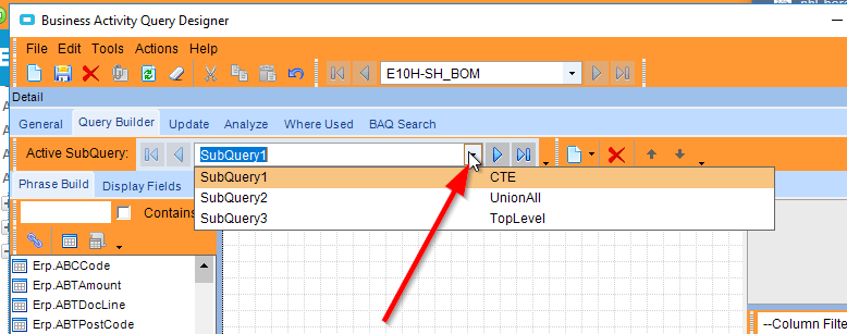

How do you edit the subquery? I’ve imported the .baq into my envioronment but can’t seem to find the window in BAQ designer where I can modify the subquery.
Thansk
“found it”
Looking to modify what fields are returned now.
