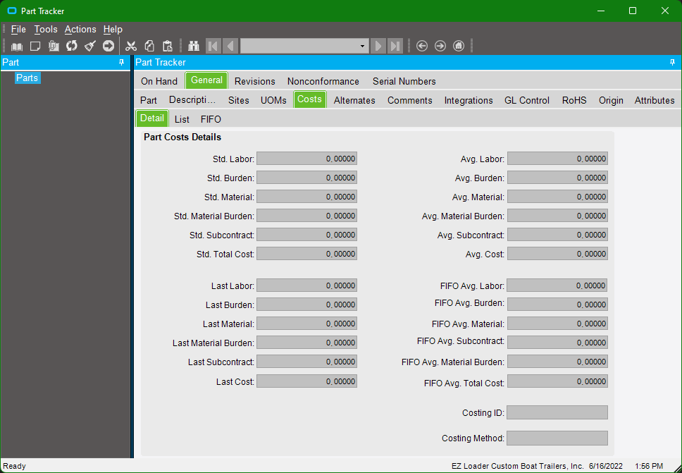

When you examine the part(s) in Part Tracker are you indeed seeing a cost in the General > Costs > Detail tab?
Sorry, Iam not seeing any cost
Then you will get no cost information out of the system as no actual cost information has been entered/loaded into the system. I know it is easily entered if missing via a cost adjustment.

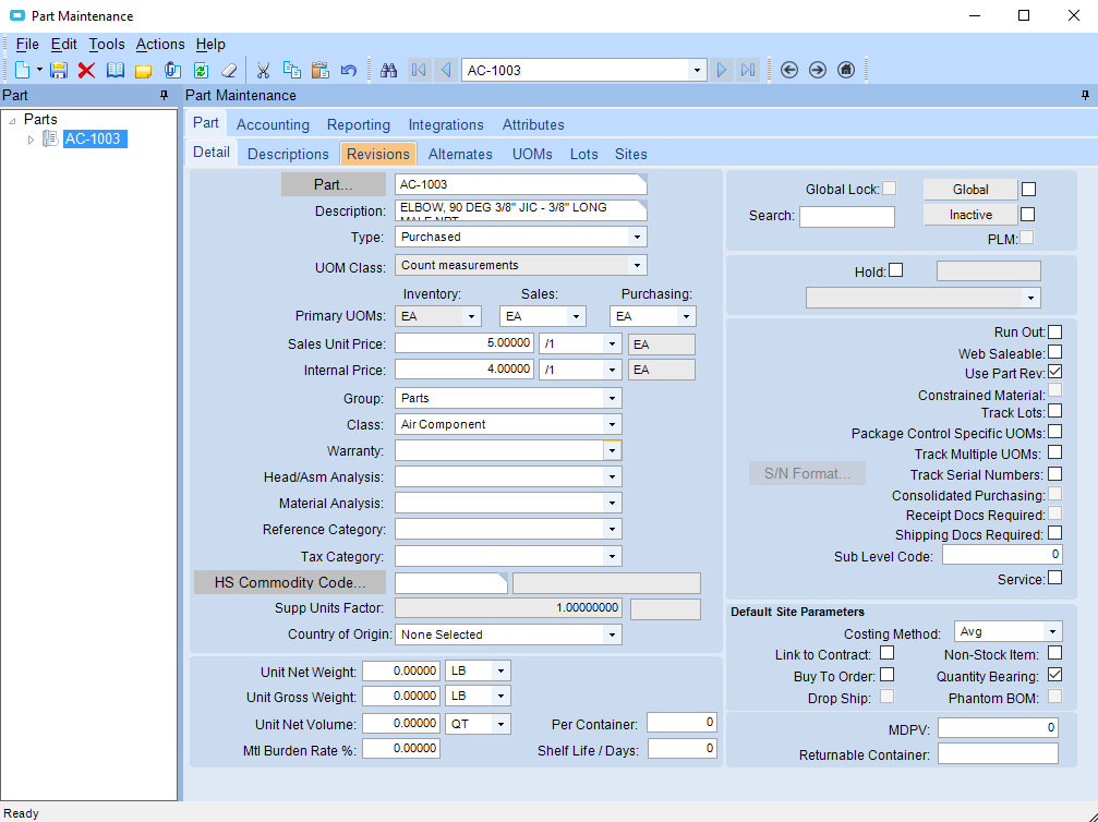

Where did you put the cost? When you say you created part A at $10, where did you put the cost? A cost adjustment?
The price was put into the sales unit price and internal price
Yup, that’s not what it uses for the costing. Those are prices that you charge your customers. You need to do a cost adjustment to get the cost in the cost tables.
Cost <> price
My old boss (plant controller) drilled that into me.
  • Cost is what you PAY (either to a supplier or to make it)
  • Price is what you CHARGE
Back when I was not a geek (kidding, that was never), I used the terms interchangeably. But they are not the same in accounting.
BOMs use part cost.

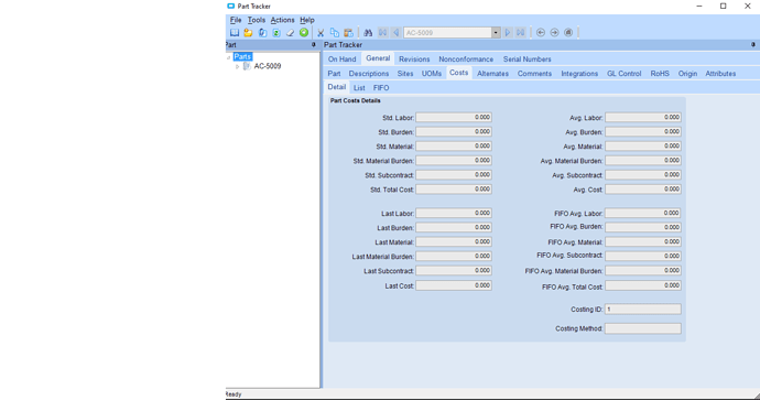

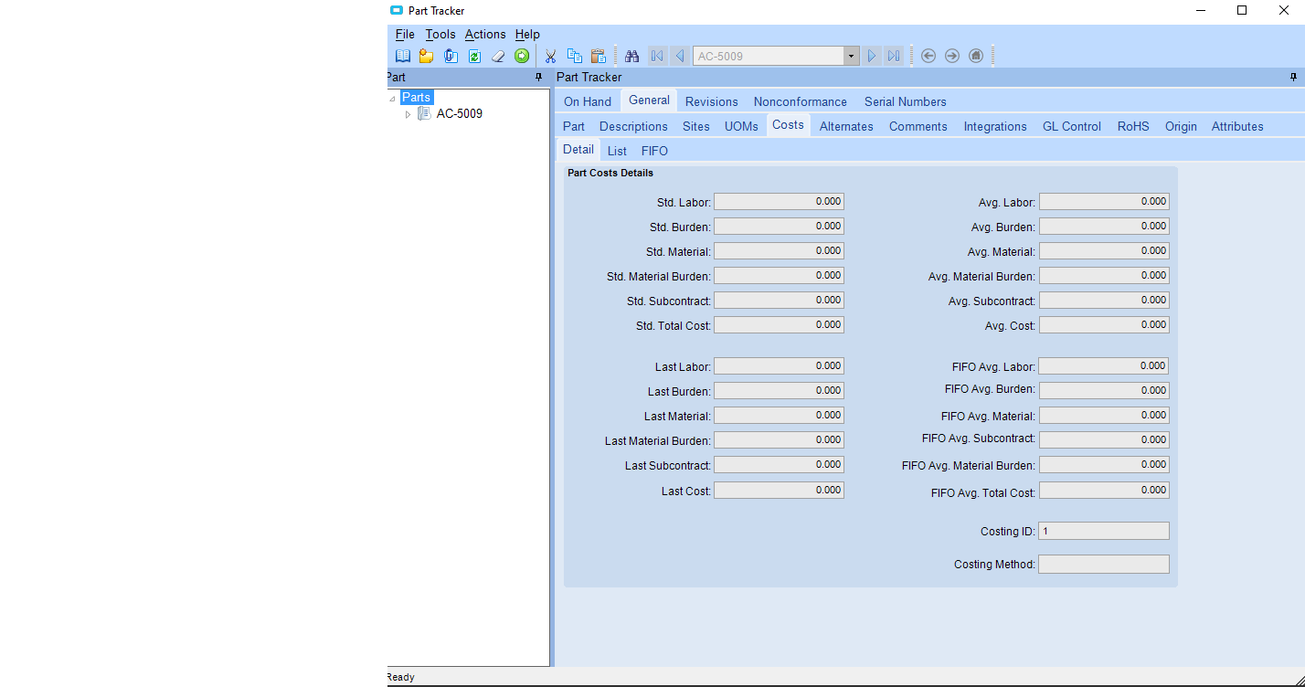

If I had a part A cost is 10 and a part cost is 5. Then I make part C and use eng workbench to add part A and part B to C, I do not see and automatic cost it shows zero.
Any suggestions
