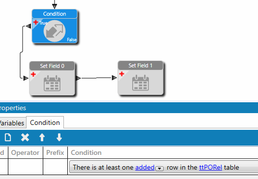

Since we don’t have any need for Change PO Suggestions, I am looking at having Epicor make a BPM to automatically make the below actions happen on all PO release lines, so the New PO Suggestions are not factoring in any of the Change PO Suggestions.
  • PORel.LockQty - If False, change to true.
  • PORel.LockDate - If False, change to true.
My question - what would you recommend as the trigger for this BPM to fire?
Any other things I should consider?
Thanks!

I do them in a PORel DD

Checking those fields in the UI or by bpm makes no suggestions except new. So if you already have POs placed that are not going to be on time and you get another new suggestion you need to be aware to cancel them or just change the dates on them.
