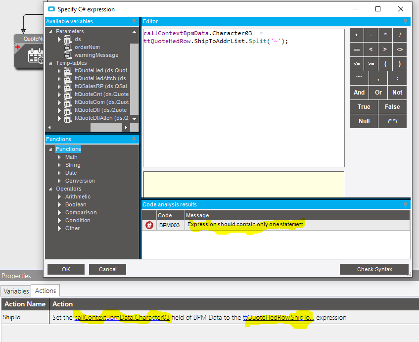

I’m trying to set the specified field of BPM Data to the specified expression
The field is Char3 the expression I’m trying is ttQuoteHedRow.ShipToAddrList
I can get it to display as a string but I can’t get it to split on “~”
Any clues please, I’m new to C#

Char3 = ttQuoteHedRow.ShipToAddrList.Split('~'); should do the trick, shouldn’t it?
Edit: except of course that returns an array. Silly me. OP, which element of the split up string do you need in Char3?

Thanks Chris, I’m getting an error, I probably used the wrong terminology in my question

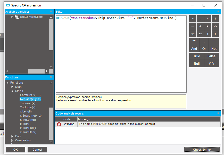

Ok so Split isn’t what you want, you probably want to replace the ~ with a line return or something:
BpmFunc.Replace(ttQuoteHedRow.ShipToAddrList, "~" , Environment.NewLine)

@Rick_Bird , That throws this error

Double Click on the Replace function you have highlighted… it’s probably BpmFunc.Replace.

Thanks @Rick_Bird , thanks all for your input
Ricks suggestion worked
BpmFunc.Replace(ttQuoteHedRow.ShipToAddrList , “~” , Environment.NewLine )
