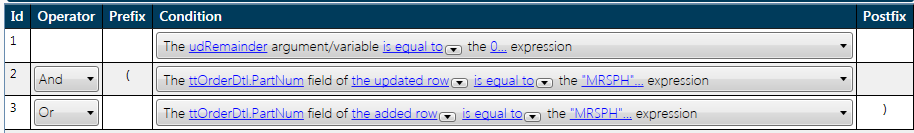

Related question: how to limit the BPM to only the conditions.
My BPM is firing for all parts added, not just MRSPH. In English, I want the warning to be displayed only if the part is MRSPH.
Thanks.
