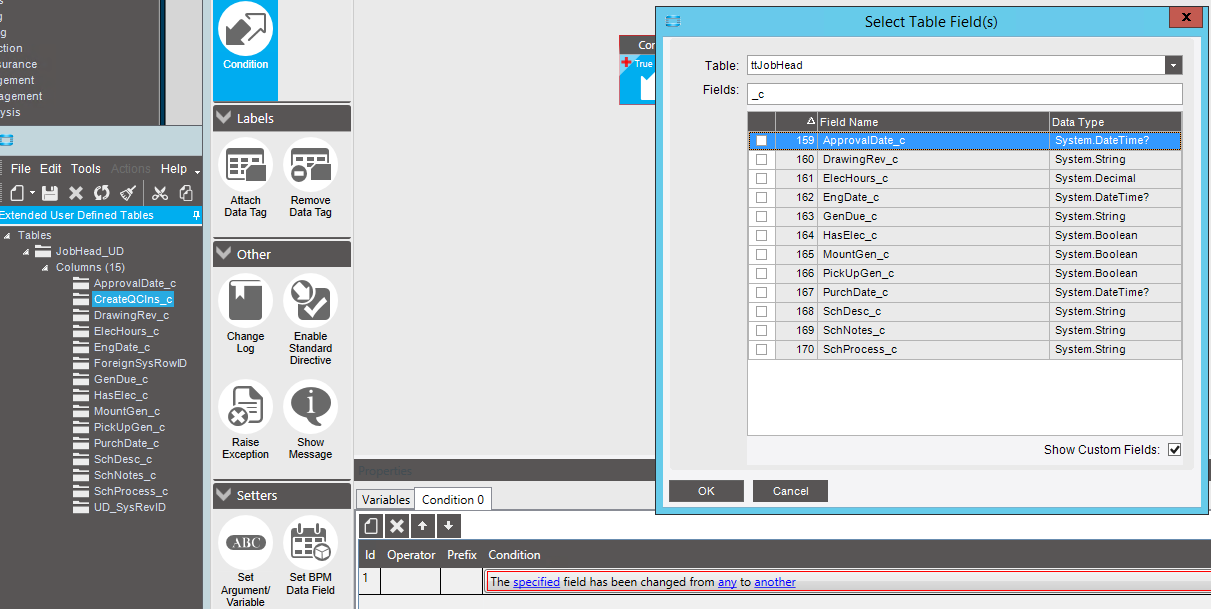

I feel like I am going crazy because this doesn’t make sense. I added a new extended UD field to JobHead. I went into a BPM to add that field in a condition and it wasn’t there. I have other UD fields on JobHead that are there, the new one is not.
The field really exists, and the data model is in sync. I was able to add the field in a customization with no problem. I tried making a new BPM and it wasn’t available in that one either.

So I can see it in a method directive, just not in a data directive… I can see it in a BAQ, and even update it with a UBAQ. But it doesn’t show up in a data directive. Odd.
I wonder if the data directive utilizes a different data model than a method directive/baq since it’s more tied to the table structure than the method schema…maybe
It’s just so odd that other custom fields are in there from before. But not since the upgrade. (This is in a test .300 environment). I suppose maybe I should call in a ticket…
Can yo make a DD for table xxxxxx_UD?
That doesn’t show up.
Not to my knowledge. however, I do not know when the temp table schema is available to the dd
I had to do the -808 cache clear. (the clear client cache in the program didn’t work). Now it shows up.
